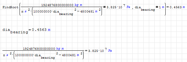

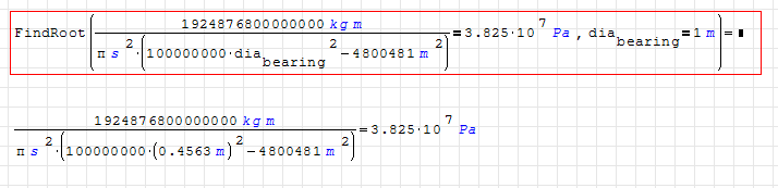

Hello Davide,
I am somewhat confused why FindRoot() cannot solve this equation. Am I doing something incorrectly?
It works just fine for some other equations..
Thanks!
FindRootCannotSolve.sm (4,59 КиБ) скачан 1527 раз(а).

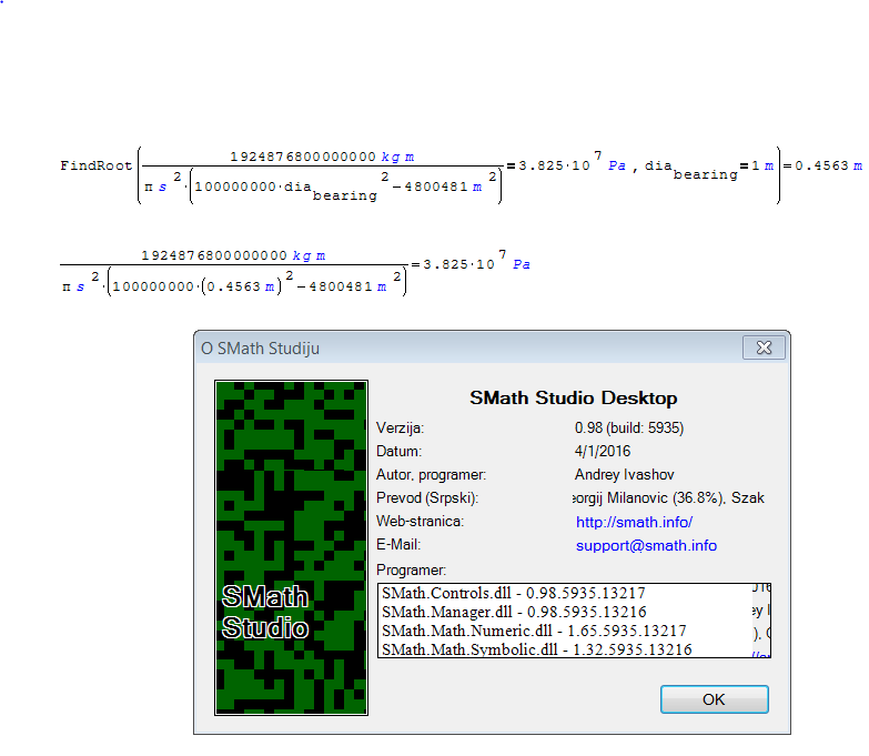

#166 Опубликовано: 07.04.2016 16:10:06
Hello Alex,
I cannot reproduce... do you have Maxima or some other plugin that may cause the issue?
#167 Опубликовано: 07.04.2016 16:18:09
It works for me. The same was mentioned some time ago here. It seems that some plugin is making trouble. I do not know which one.
#168 Опубликовано: 07.04.2016 17:03:40
Alexander O. Melnik
Alexander O. Melnik
Omorr, Davide:
- Uninstalling Maxima plugin did nothing
- Clean install of stable 0.98 SMath Studio solved the issue. Now I just need to find what other plugin is wreaking havoc there..
Thank you

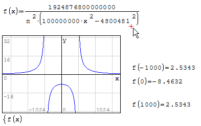

#169 Опубликовано: 07.04.2016 22:57:46

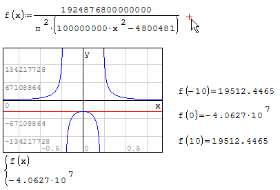

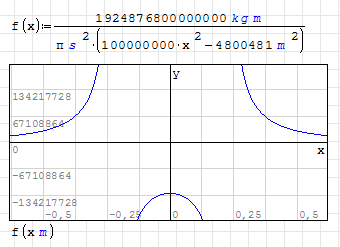

Maths are unitless, therefore plot first the generatrix
to discover the function has no root(s). If you fabricate
with a unit system, you will have no plot. That's what I
call "invisible project"

#170 Опубликовано: 07.04.2016 23:01:10
... the other point is that Smathh is too granular to
reveal the Gaussian part of the function.
#171 Опубликовано: 07.04.2016 23:16:56
Mike Kaganski
Mike Kaganski
You make a wrong point here. You prefer to avoid using units in your sheets, and that's your right; but declaring that units are inappropriate (as you do now and again) is spreading FUD. Using units is a great feature of SMath (that is optional, so that you may choose to work as you like), but your unawareness of ways to take advantage from using units while keeping ability to, e.g., plotting, doesn't mean that it's good to state such bold claims (insted, you could simply create a new thread in "Questions" and ask others how to plot while using units).
Second, the function itself doesn't have roots, but original poster looked not for equation f(x)=0, but for f(x)=n, which is f(x)-n=0.
Third, you mistakingly put square for pi (it was meant for seconds, not for pi - if you used units, you would katch this, because the result would arrive in s*Pa).
С уважением, Михаил Каганский
#172 Опубликовано: 07.04.2016 23:54:08
... maybe that's what you had 4800481^2 instead of
4800481 m^2... just different scale plot. Whatever,
the negative branch has two symmetric complex roots.

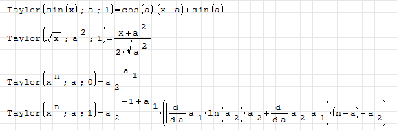

#177 Опубликовано: 09.09.2016 16:41:23
The Taylor() function throws the error message "Specify variable"
How am I expected to do this?

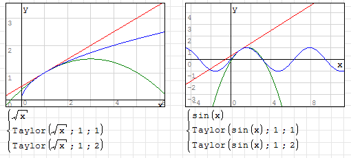

#178 Опубликовано: 09.09.2016 17:39:24
As it looks Martin, "Taylor" is by default.
#179 Опубликовано: 09.09.2016 18:54:26
You assigned a wrong value for the 2nd argument, "2:variable".

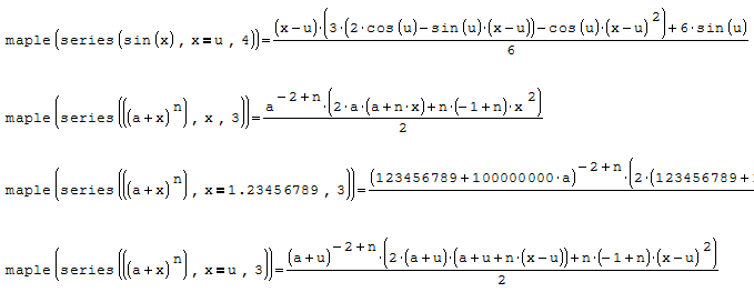

#180 Опубликовано: 09.09.2016 20:15:05
Hm, don't understand. For univariate expressions, the second argument is the development point.
For multivariate expressions, I would expect that I have to specify the independent variable and the development point.
In Maxima (not working in newer versions of SMath) it looks like this:
With your Taylor, I have this:
Sorry, I don't understand the result.
