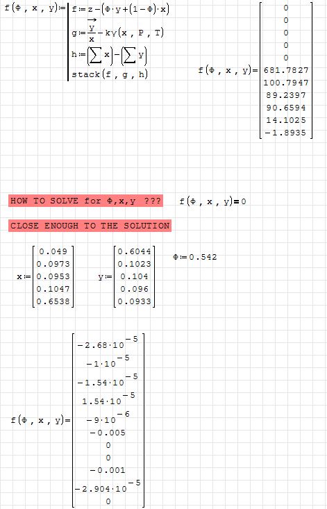

After so many years struggling with SMath and nonlinear problems (system of nonlinear algebraic equations, nonlinear optimization) I have to admit that whenever I want to do that in SMath (more than two, three variables), I get few gray hairs . See for example this one (doomed for me...). At the moment, I just do not know how to solve this
SMath file - Be my guest if you want to solve it
Primer38-doomed.sm (27,71 КиБ) скачан 1714 раз(а).
Davide Carpi 21.10.2016 11:14:00

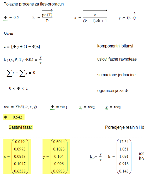

Here is the same problem solved in Mathcad
#189 Опубликовано: 21.10.2016 21:52:25

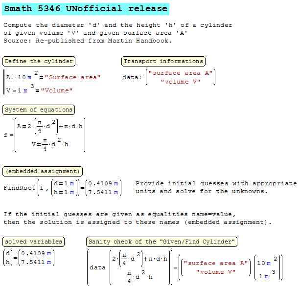

Solve Given_Find [UN Cylinder].sm (62,91 КиБ) скачан 1589 раз(а).

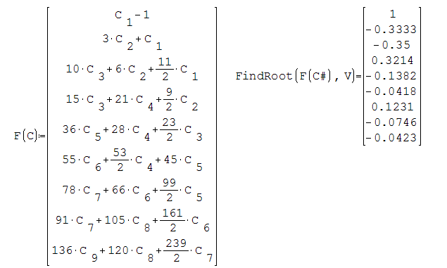

Thank you for this example,
FindRoot() goes with it well. You have nine clear defined expressions (F vector) with nine unknowns (V vector), and FindRoot() will do the job
By the way, if all the initial values are the same we can use the standard trick : V[9:=0 , V:=V+1 : and all nine vector elements will have unity values. This is all right, I think, because this will give: Unknowns(F)=[C] which means the unknowns is C - it happened to be a vector. But, your construction is more understandable, I think.
Moreover, this way will also work

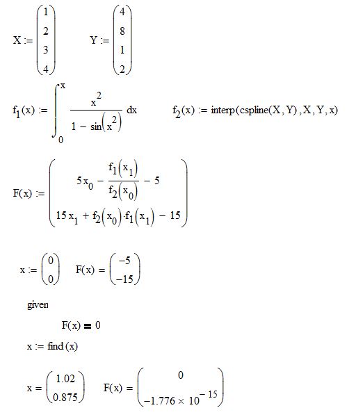

Here is the test example which is intended to point out that SMath should be capable of solving this (two nonlinear equations with two unknowns), by using the functions from this plugin.
I failed by everything I try.
