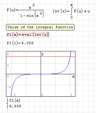

#204 Опубликовано: 25.10.2016 00:49:16
You are right Radovan,
Smath splines [ainterp, cinterp, linterp] are "canvas" plotting
and on-line evaluation. They don't create a function thus can't be
use to integrate directly. You have two alternatives:
1. Dicretise/integrate finites differences
2. Transit via Infinitesimal modules
I went as far as I could in the attached. Plotting the components.
The "solve" block fails miserably, why?
It attempts to retrieve back to the integral that Smath does not
produce. The "solve" does not interpret the integral transit because
the solve block is a foreign entity. The Mathcad find(x) looks incorrect.
It depends upon initialisation. In this case the worng checks right.
Though the Mathcad Given/Find is often robust, it failed 1000's times
in my 15 years Mathacd collab.
Mathcad plots your integral, smath does not, thus it reflects in the "solve".
Please don't hesitate to correct me if I can help more.
Cheers, Jean
Forum Radovan Integral.sm (192,6 КиБ) скачан 1836 раз(а).
#205 Опубликовано: 25.10.2016 02:43:38
Hello Jean,
The integral works form me (the recent SMath version)
solve() works for me as well
Why is this working for me and not for you - I do not know.

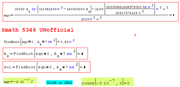

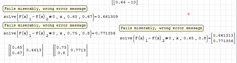

#206 Опубликовано: 25.10.2016 10:07:02
Simple: the solve block of your version is more robust
or the chained code less reactive ? The other curiosity
5346 official release ..... 120 sec
5346 UNofficial release.... 14 sec
I got used to solve failure, rescue dichotomy.
BTW: eval(,) is not needed for f1(x)[faster].
Thanks Radovan, your collaboration is most appreciated.
Radovan Omorjan 25.10.2016 10:57:00
#207 Опубликовано: 25.10.2016 10:20:54
Chain code error confirmed.

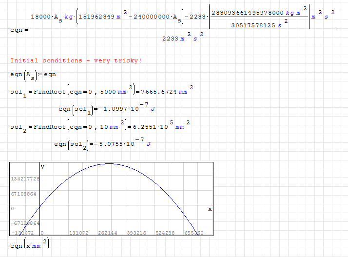

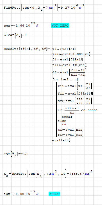

Alexander O. Melnik
Alexander O. Melnik
Davide,

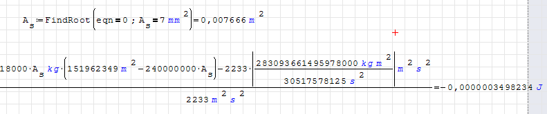

Here is an unforunate example of FindRoot() being unable to solve a problems with units... While my very quick NR Line() solver works just fine.
I wonder if we run into max + number problem or devision by zero.
Hoping for a fix!
FindRootBug.sm (11,93 КиБ) скачан 1648 раз(а).

#209 Опубликовано: 27.10.2016 04:26:45
Not sure why it fails in 1.0/1.1, but will works in next version
Alexander O. Melnik 27.10.2016 12:13:00, Radovan Omorjan 27.10.2016 05:28:00

#211 Опубликовано: 27.10.2016 11:10:42
Actually, it could be done - but setting the initial conditions for FindRoot() could be very troublesome for this example.
Initial conditions are chosen just on trial and error, and the calculation can diverge easily by slight changing of IC.
This is basically a second order polynomial having two solutions.
FindRootBug-corr.sm (16,62 КиБ) скачан 1625 раз(а).

#213 Опубликовано: 27.10.2016 12:12:28
Alexander O. Melnik
Alexander O. Melnik
Is there a reason why solver would gravitate to wards a solution further from initial guess? If it were just to follow the slope at the initial guess value it would arrive to the closer, and in my case correct, solution
So far in my expirience it is almost always possible to make FindRoot() solve by substituting just the right value. There has to be a reaon why the function tends to overshoot nearest solution by so much. Also when it does not find a desired solution, the number it spits out is not always a mathematical solution either
Radovan Omorjan 27.10.2016 14:56:00
#214 Опубликовано: 28.10.2016 02:30:42
We might say that often some numerical procedures (especially nonlinear) may "go nuts" sometimes and give the unrealistic solutions. Therefore, we have to have the ability to use few of them for the same task. In this plugin there are many procedures for root finding we could use beside FindRoot(), but they are not working at the moment (or I do not know how to use them anymore).
#215 Опубликовано: 28.10.2016 04:41:14
IC are a very sensible parameter in nonlinear solvers; you might know in advance an expected "order of magnitude" and the results still diverge because locally the function is too much or not enough steeper (or because there is another solution close).
For single variable problems I plan to add these algorithms, in which solutions are bounded in a range. Even, I guess would be possible to add some kind of "filter" to discard some solution (however, would be a replacement for something that should be done in any case: sanity check if the result fits personal needs).

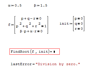

#218 Опубликовано: 29.10.2016 11:37:11
Just for the record (especially for Davide) FindRooot() just does not work in the recent SMath for few of your examples with the error like in the picture. Actaually, it does work when you change the IC from zero to some other values.
Davide Carpi 29.10.2016 12:28:00

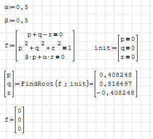

#219 Опубликовано: 29.10.2016 12:24:52
Radovan Omorjan 29.10.2016 13:50:00
#220 Опубликовано: 29.10.2016 14:14:57
That's not a bug Radovan:
=>...For the free finding solutions, IC must be either 0 or 1
[1 to releive from "divide by zero"]<= ... {previous message}
Maybe you are not up to date vs Davide ?
