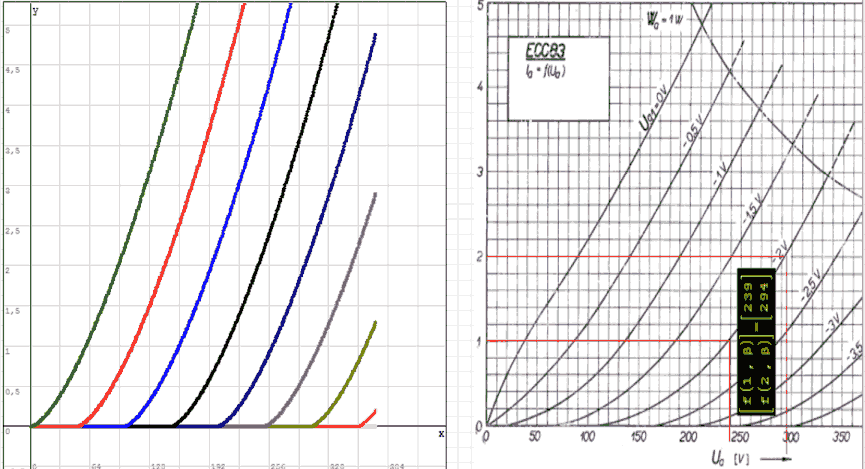

Thanks CBG for interest and involvement. As I have already said, a domain-defined function is not useful, since these domains can not be specified through the script that puts this function into a specific simulation program, such as Multisim - for example. For this reason, a single function must be defined to be continuous and derivative on the intervals -4

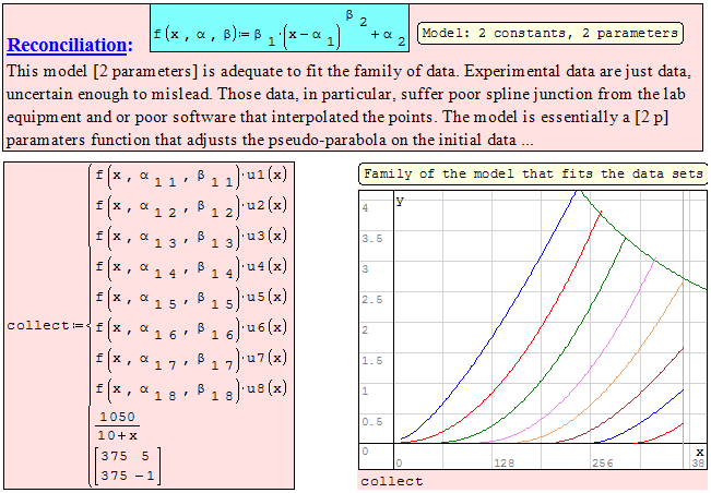

a domain-defined function is not useful, since these domains can not be specified through the script that puts this function into a specific simulation program, such as Multisim.
If Multisim can't take a mathematical expression from Smath or else ... what can you do?
Just recycle Multisim because as you say it is not a math tool, just a gadget.
Maybe it can take the plot [te 9 plots in sequence] of your Tesla.
1. Those plots, you have them from Carlos and I offer from more compacted polynomial fit.
2. Those plots, you have them as from the "x*ln(1+exp(Ug/x)) , which basically the function
you attempted in your Mathcad that failed miserably.
3. Both proposals [Carlos, Jean] are smooth, monotonous, continuously derivable/integrable.
Don't neglect understanding the note:
"The polynomial fit tends to fit as well the defective digitized data.
Digitized data are inaccurate by themselves and more inaccurate from
the french curve spline creator from not true analog experiment in
the original Tesla lab work."
In short: Smath recovers your TESLA [1959].
Multisim is left to be coded to read either maths or Smath graphs
Genfit Minimize TESLA RECONCILIATION.sm (389.53 KiB)已下载 1172 次。

Thank you very much Jean for your accurate response.
HOLA Ola_Nicolas!!!
What I did, was simply find the equation that represents each curve
of the given graph. The functions are continuous, but when representing
a polynomial of 4 degree, they are unstable outside the specified ranges.
On the other hand, doing a little research, I found that the curves of
the TESLA graph were constructed with the equations of Scott Reynolds
and Marshall Leachfon, or with the improved equations of Normal L. Koren.

That's how things stand until I study the issue of collaboration between SMath Studio and my simulator, my greatest interest is focused on a complicated method of determining coefficients for the Koren equation that I presented in the first post . Otherwise, all the best.
Salut Nicolas, I was not gone fishing !
I read most of the link about Norman Koren work.
Norman formulation(s) meets his experimental data, fine, gorgeous work.
IMHO, Norman and others are not correct from the onset ... Explain:
The physics of the system is the XFR of the system [Transfer Function]
Each system has its own XFR ... one is exemplified in the attached,
from the data generated by Carlos from Norman simplified formulation.
To resume your concern:
1. get reliable data from your simulator
2. attach those data, we will try solving the XFR.
Project Tesla_CBG_R1 [optimized] Copy.sm (212.5 KiB)已下载 1048 次。

I have added another model at the end. Can't be automated either.
Project Tesla_CBG_R1 [optimized] Copy.sm (234.13 KiB)已下载 1071 次。

983个赞,共6,866个帖子。
IMHO =
... this model should solve all curves.
It solves/iterates nicely for this particular data set.
f(x,β) recovers from the reduced solving procedure.
Genfit Minimze Tesla.sm (45.6 KiB)已下载 1197 次。

I'm just trying to do it. Otherwise today there are all kinds of complex electronic devices for automatic drawing of the curves characteristic of the triodes and the pentodes.
Ok ... Savant gadgets are just gadgets, proof: the one you have used has muffed
your lab test. L. Koren equation is phenomenological as it says. Unfortunately,
experimental data are not exactly reproducible. Nothing in the circuitry is
reproducible not even the triode/pentode ... think of similar physics wrt T/C
T/C = Thermocouples. In short, the Creator was short of fully understanding what
He was creating.
Your complex attempted formulation does not speak to me.
The attached proposal fits your data sets based on 2 parameters and 2 fixed constants.
The constants are the initials X, Y of each experiment. It needs only two parameters
for each experiment. The model function is not suitable for auto-iterate ... peanut
work to calculate trial/error.
If possible, it would be interesting your collect ~ 20 points, raw ... as measured
with good equipment. No processing, no spline curve junction.
Salut Nicolas, will read you soon ... Jean
Genfit Minimize Tesla(5) Copy.sm (207.62 KiB)已下载 1232 次。
... easy to trick the argument (x+ε)
Now, with a single set of initial β it iterates
and fits all data sets !
Genfit Minimize Tesla(5) Auto_Iterate.sm (211.37 KiB)已下载 1237 次。

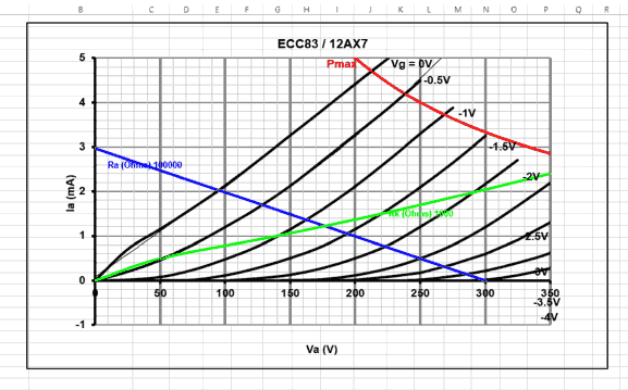

I found this page that I hope will be useful:
http://www.valvewizard.co.uk/links.html
It contains a file in excel for the calculation of the triodes graphs
LoadLinePlotter.xls (817 KiB)已下载 750 次。
Thanks Carlos, interesting visit.
