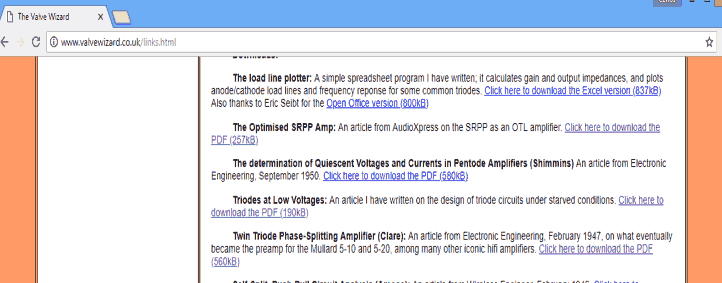

Bună ziua Nicolas
Registration is not required on the page. The file can be downloaded directly from:
salutări
Hello Jean

Thanks both for your greetings
I see that now the link posted by Carlos to message # 39 has been opened. But there is a list of links. Which one leads to the excel document? ...
... It's okay, I found it.

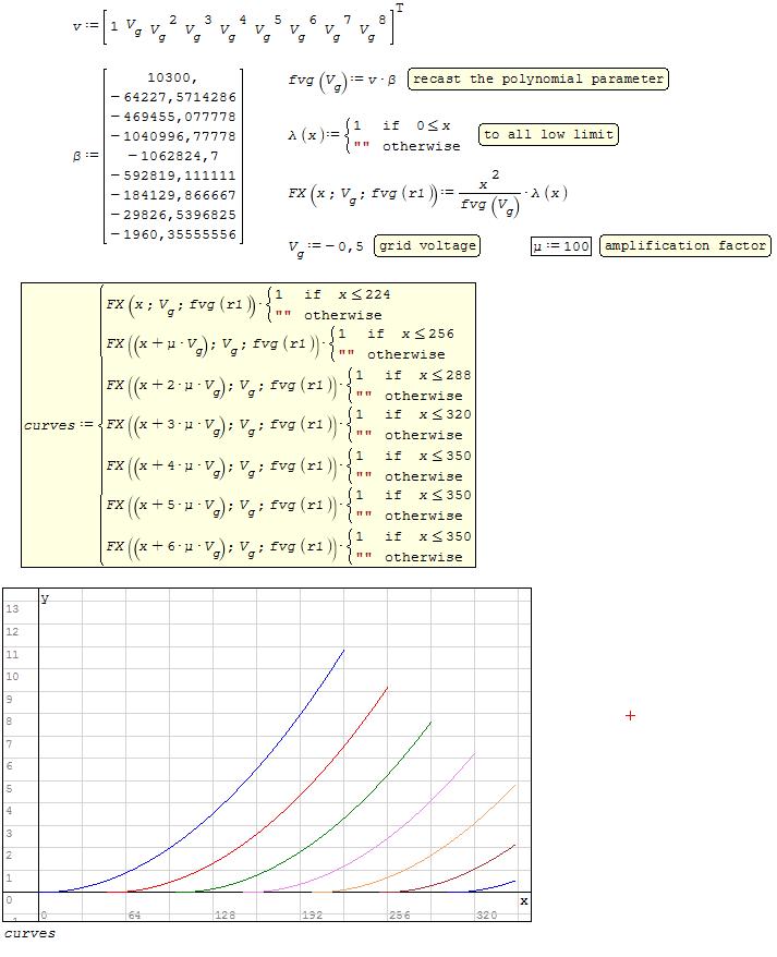

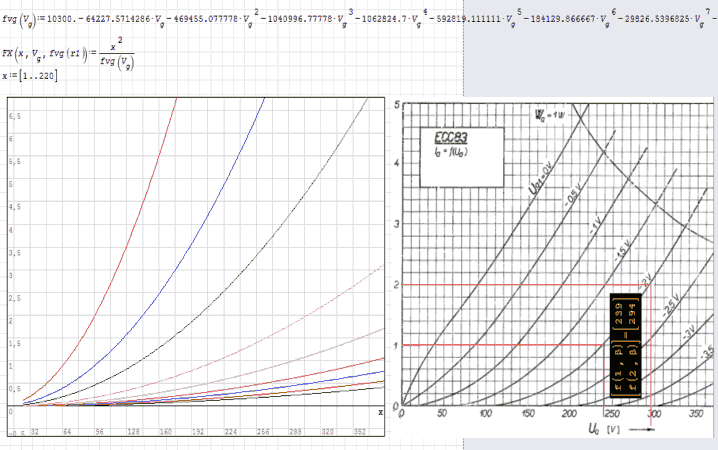

#47 已发布: 2018/6/18 12:10:20
Nicolae Olaru
Nicolae Olaru
1个赞,共115个帖子。
Greetings
I do not know what "r1" is in Carlos's relationship. And then what I see does not correspond visually to the diagrams in the datasheet.
... And what about the first curve?
Nicolas
#48 已发布: 2018/6/18 17:27:23
983个赞,共6,866个帖子。
1. The parameter 'r1' is not accounted ... removed
2. This is experimental from observed ... your data set is phenomenological.
So, they don't relate. You had the XFR phenomenological from before.
3. "first curve" is not experimental ... a fake one added.
Project Tesla_Origen_CBG_Jean [Refactored].sm (11.72 KiB)已下载 1060 次。
#49 已发布: 2018/6/19 02:27:25
Nicolae Olaru
Nicolae Olaru
1个赞,共115个帖子。
Hello
Very good. Let's say that in the file attached to you, we have the desired shape of the curves. Basically, I only got a beam of curves similar to those in the datasheet. How do I now define the unique function that will generate for each pair of Va and Vg variables the Static Operating Point (SOP)? I do not really need a picture of the characteristic curves, but a relationship that generates for each couple of input data a single SOP in the voltage-current plane. In other words, we look at the variable Vg as one that takes values in a continuous domain, and not a sequence of predetermined values. As I have already mentioned, the mathematical model is going to be useful in a simulation program.
Nicolas

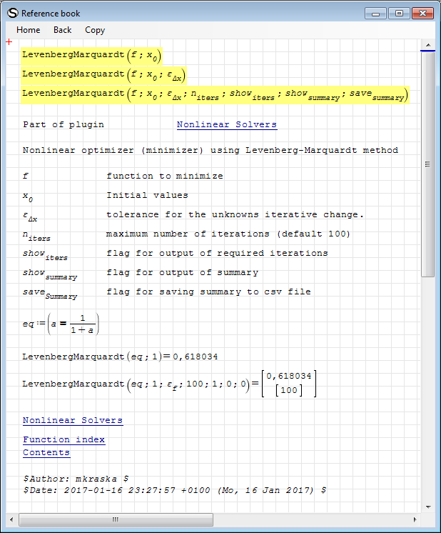

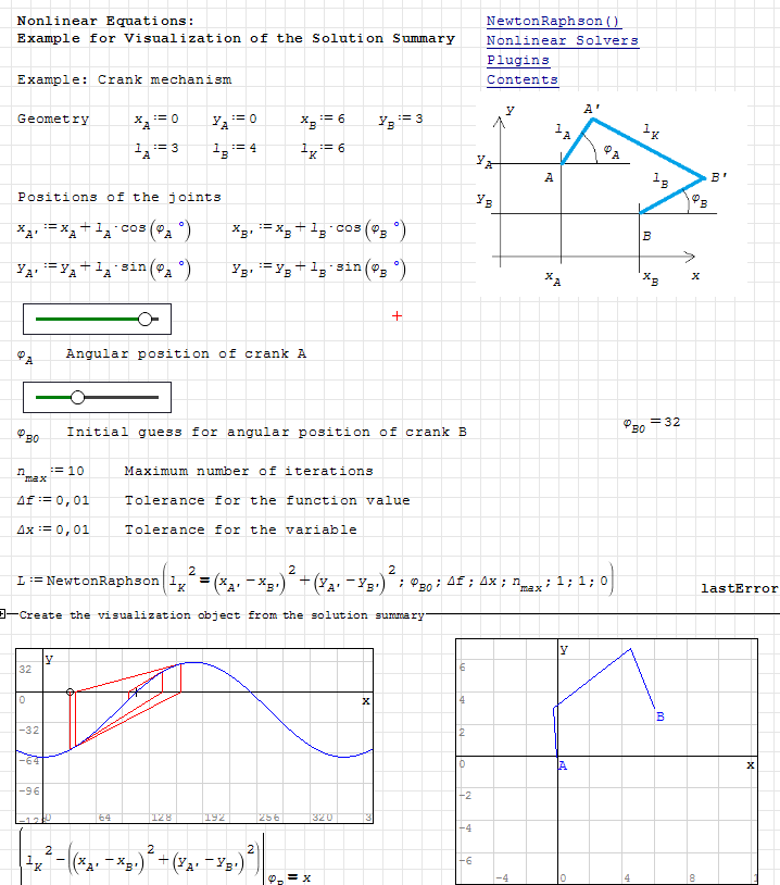

#52 已发布: 2018/6/26 19:12:22
1,362个赞,共2,276个帖子。
Hello everybody
The Levenberg-Marquardt method can be (I hope) closely related to solving the non-linear equation system that interests me. In SMath, however, there are seven different variants of the Levenberg-Marquardt method. I think I understand what it is about LevenbergMarquardt (2) and LevenbergMarquardt (3). I ask someone to explain what are the input sizes for the variants: LevenbergMarquardt (7); LevenbergMarquardtCD (2); LevenbergMarquardtCD (3); LevenbergMarquardtCD (4) and LevenbergMarquardtCD (8). Small examples of application would be very useful. All the best.
Nicolas
Try the interactive handbook.
Goto Functions Index, open the L area and Ctrl-Click to LevenbergMarquardt(). In the Nonlinear Solvers page you find a link on how to visualize the solution history.
2位用户喜欢此帖子
bdrunagle 2018/6/27 04:00:00, frapuano 2018/6/26 19:16:00

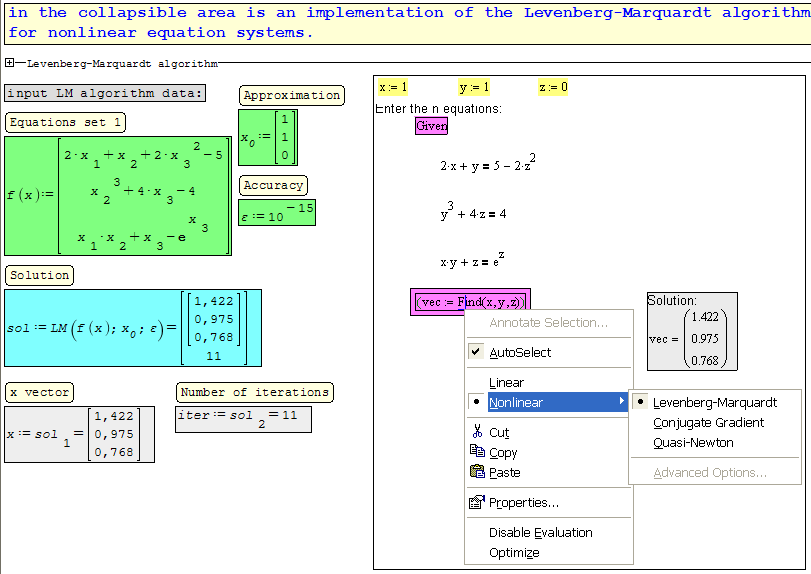

#54 已发布: 2018/7/5 15:17:52
Nicolae Olaru
Nicolae Olaru
1个赞,共115个帖子。
Hello everybody
I have tried to write an algorithm in SMath to solve systems with several equations. In the attachment I have illustrated how with this algorithm I managed to solve the equation system given as an example in QuickSheets in MathCAD. I also provided the SMath file in the second attachment. Using the same algorithm I then tried to solve the problem defined in message # 1 of this topic - see the SMath file in attachment 3. After 7 iterations, the loop while from the algorithm comprised in the collapsible area became an infinite loop because size Δp has an error and the program perceives it as indefinite, although calculated separately the right member of the equation that on Δp has a finite value. I have set the spreadsheet for this file without using automatic calculation, because the higher the computing time, the computer's system memory resources are becoming less and less programmatic and the program tends to block the system. In program, the mm size set to mm = 1 corresponds to a current expressed in mA, while set to mm = 0.001 resulting streams will be scaled to Amps. To run the file, use the "Recalculate page" command in the "Calculation" toolbar, after which it will stop running after the first 20 ... 30 minutes. As the personal observations I could make, the variable vector does not change locally after 7 iterations, and the damping factor μ has a value very close to zero. Not being very experienced in such algorithms, I can not figure out where the wrong is. Perhaps the others will try to solve with me such a problem, which they will take as a challenge. Otherwise, good luck to everyone.
Nicolas
About Levenberg-Marquardt algorithm.sm (44.36 KiB)已下载 1211 次。
About Levenberg-Marquardt algorithm_.sm (58.82 KiB)已下载 1257 次。
#55 已发布: 2018/7/5 17:22:30
325个赞和1个踩,共2,052个帖子。
Unfortunately, numerically solving the system of more than few nonlinear equations is quite a problematic thing to do in SMath. After all these years I think this is one of the thing that will never be resolved in SMath in an efficient way.
#56 已发布: 2018/7/5 20:01:34
