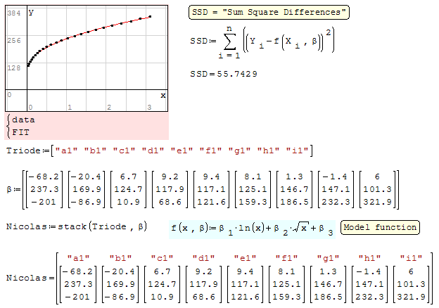

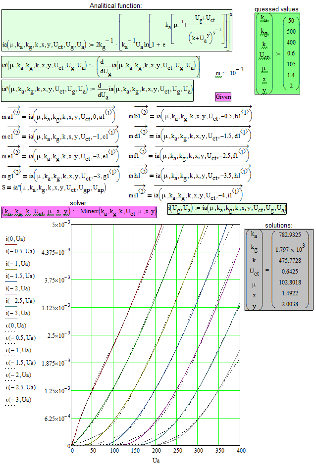

Greetings.

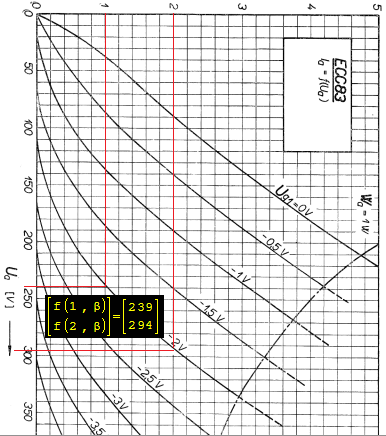

This is an attempt to approximate the physical graphical characteristics determined by the manufacturers of some electronic devices with a family of curves of an analytical function. In Figure 1 I presented a solution in MathCAD using the Given / Find block associated with the Levenberg-Marquardt method. The values of the guessed elements were determined by probing so that the curves of the analytical function (continuous colored lines) overlap as precisely as possible over the curves determined by the measurements (dotted lines). In Attachment 2, I imagined a solution by applying the same Levenberg-Marquardt method. I do not know why I got the error in the picture. Maybe someone could explain to me, or maybe already has a solution to the problem. All the best.
The Mathcad/Mathsoft block Given/Find, Minerr, Minimize, Maximize is a proprietary wrapup
of Numerical Recipes. No such thing is even close in Smath. Further, few of the parameters
in your Mathcad image are from the blue and no data set. Up until now: can't help.
On the other hand, I have 70 Smath work sheets optimizing model function(s) wrt to
data set, based on Conjugate Gradient, iterated manually.
If you are willing, post ONE [only one] data set c/w no parameters from the blue.
Genfit Minimize Power Model.sm (30.03 KiB)已下载 1258 次。
#3 已发布: 2018/5/27 18:46:31
1,443个赞,共2,936个帖子。
Try using line() on the RHS but without file it's hard to say what's going wrong

... your Mathcad fit graphs look pure scrap to me.
If you hardly have two fits, then the model is incorrect.
Genfit [NOT Done xo Exp].sm (33.87 KiB)已下载 1068 次。... suggestive

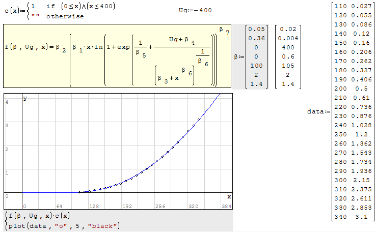

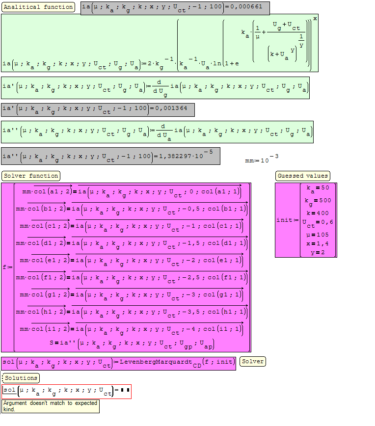

Hello.
Here is an applicable file. In this case, all variables (μ, ka, kg, k, x, y, Uct) are positive according to the results obtained in MathCAD. The Ug and Ua variables are control parameters. Ug takes values between -4 and 0. Ua takes values between 0 and 300. The sizes I have inadvertently deleted have the values: S = 0.0016, Ugp = -2 and Uap = 250. I apologize for the inconvenience.
LM.sm (61.23 KiB)已下载 1227 次。

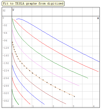

#6 已发布: 2018/5/28 11:17:40
983个赞,共6,866个帖子。
... according to the results obtained in MathCAD.
OK ! but you have nothing worth from Mathcad, looking at the plots.
1. Your model function looks to complicated if it would work.
2. Intuitively, it would be Given/Find ... NOT Given/Minerr.
3. ... and the derivative would have nothing to do in there.
Tentatively, I have fitted two data sets.
Don't forget your data sets are from foreign source, thus just "data".
If you just want to fit all data sets, please confirm, give me two days.
I have no idea how each one is headache !
The concept of "bing/bang/auto/done ... " is BS IMHO [In My Humble Opinion].
OlaNicolas.sm (42.05 KiB)已下载 1221 次。

Hello Jean Giraud.
I wrote "Given / Find" in the first post. It's actually "Given / Minerr". I'm sorry for the inconvenience. Check out my previous post. I mentioned some data that I accidentally deleted from the previously attached file. The partial derivative of the function (ia) takes in relation to Ua, it is necessary to achieve the slope of the curves, the S-dimension being an important parameter of the electronic devices in question. Now I will analyze your file.

Nick,
You have 9 data sets, what do you want to with them ?
Mathcad does nothing visible, Smath will do less or nothing.
I have 3 data sets left to fit for tonight.
'a1' looks monkey business ... maybe too long ?

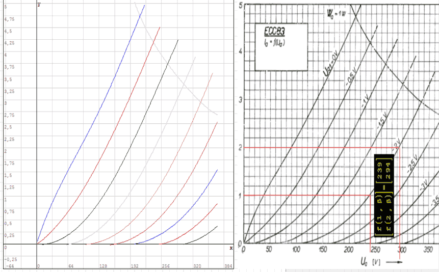

Hello.
One of the many datasheets of the electronic device in question can be found here: http://www.datasheetspdf.com/pdf-down/E/C/C/ECC83-TESLA.pdf The graphic features I am talking about are on page 12 of the document. The array of data arrays a1, b1, ..., i1 has been sampled by sufficiently accurate methods following those characteristics. My purpose is to determine an applicable set of μ, ka, kg, k, x, y and Uct parameters of the analytical function so as to approximate as accurately as possible those characteristics. I know that SMath may be less than MathCAD, but I would like to find even a less extensive method to achieve approximation. That's why maybe only 5 of the 9 data arrays could be used. Or perhaps even some less epaining methods would be found.
Cheers, Nick.

Oh ! my goodness ... your data sets are reversed ordered.
You have X in col[2] ,,, Y in col[1]
I guess it will fit easier +++ zap all zeros [what are they doing in there ?
OlaNicolas(1).sm (101.95 KiB)已下载 1189 次。 ... in the mean time.
I guess it will fit easier zap all zeros [what are they doing in there ?
Once the data sets are ordered and stripped from zeros, < 1 min job fit .
Genfit Minimze Nicolas.sm (70.33 KiB)已下载 1160 次。

Hello.
The data is not reversed. Look better at the original chart. On the abscissa are the anodic voltages, while the anodic currents are on the order. Correspondingly we have tensions in the first column and currents in the second. Now looking at your chart, you will see that it is symmetrical with the first bisector of the axes, that is, the opposite of the original one.
#13 已发布: 2018/5/29 09:04:23
983个赞,共6,866个帖子。
Hello.
Nick,
Read the other way around: TESLA is walking on the head ... Smath Descartes walk on feet !
TESLA graphs were done by hand [1959], from analog equipment ... just put on graph paper
and done by French Curves. OK well drawn and well digitized. The model function prposed
looks more than valid. From the residuals, you can see the French Curves arcs. This is
obvious because the model function is purely monotonous.
Flip the PC screen up side down to see TESLA graphs.
OBSERVE: the model function is robust wrt Conjugate Gradient, a single set of initials.
Thus, the system could be done recursively for all the data sets [not offered].
Genfit Minimze Nicolas.sm (198.61 KiB)已下载 1249 次。 ... refreshed
