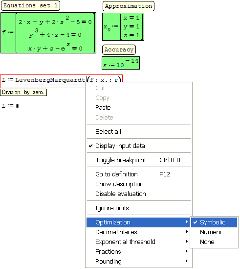

I think it would not be bad for Davide to verify my algorithm (it does not correspond in any case to the syntactic precepts used in SMath) to append it and add it to its other models, from where I saw the Levenberg-Marquardt method missing . I will not have claims. What Martin has suggested to me is useless in this case. In the file below I tried to apply LevenbergMarquardt(3) to the simple example of 3 unknown 3 equations that appears in the picture in message # 54. An error occurred.

In the given case LM works with symbolic optimization, but not with numeric. Also, z=0 does not work as initial value.

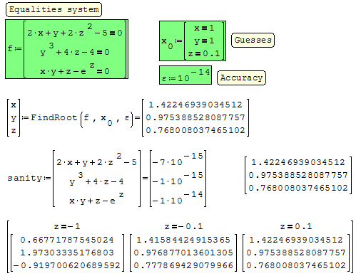

1个赞,共115个帖子。

983个赞,共6,866个帖子。
I do not even achieve symbolic optimization.
Try FindRoot NUMERIC. It solves for 3 sets of initials.

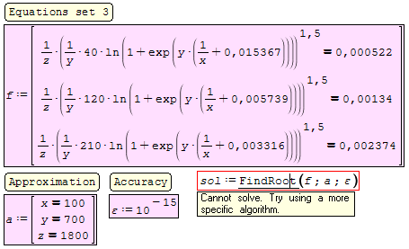

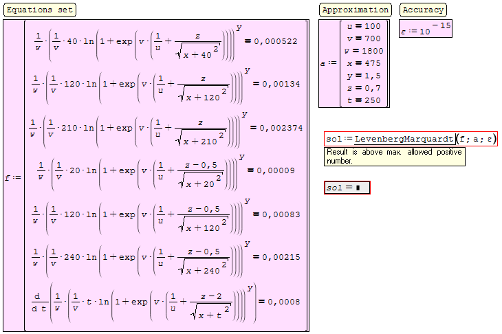

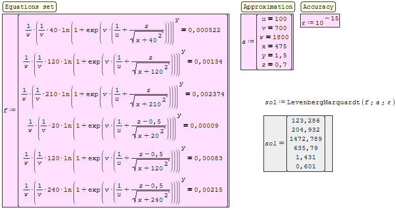

Bonjour Jean Giraud
I think it was a mere chance that the FindRoot algorithm solved that system. Try the system in the first picture. You will get the error "Cannot solve. Try using a more specific algorithm". Actually, that's what it is all about. Taking into account all the existing plugins, you need to test a wide variety of possible "more specific" algorithms. But by putting six equations of my system in the form of the image, I finally managed to get a first result using the LevenbergMarquardt algorithm (3) - even if I had to wait almost a minute and 37 seconds. It is illustrated in the second image. What did I actually do? I actually chose three disparate points on the first curve (one with a special shape) and three more on the second curve and formed a system of 6 equations. I have managed to solve it, as shown in the second picture, but the solution is far from the (very precise) found by MathCAD. As soon as I have attached another equation (the seventh) that actually represents a constraint on the system, I have not gotten anything, as shown in the third image. In this sense, it is also necessary to work in SMath. First of all you need to find more efficient algorithms for constrained systems. Then you must necessarily find a way for the program to automatically choose between all possible algorithms, only the applicable one. Let's look at things in the following way. The FindRoot algorithm in SMath could be the GivenFind algorithm in MathCAD. This must actually be a special algorithm to choose the applicable method. Among the applicable methods algorithms with constraints should also be included. Only in this way the work of a researcher using SMath as a tool can be effective. It must be borne in mind that the researcher is not necessarily an excellent mathematician of analysis, but perhaps only one of the occasions, who only attempts to obtain the results that interest him in a particular process. Otherwise, all my respect for everyone, and all the best.
Nicolas.

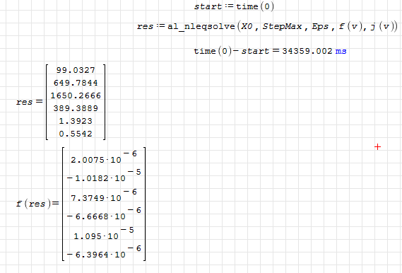

#75 已发布: 2018/7/8 15:46:17
325个赞和1个踩,共2,052个帖子。
Another solver from Alglib. I just copied from this post.
al_nleqsolve-corr.sm (19.89 KiB)已下载 1218 次。
This is a gradient algorithm. You need Jacobian, unfortunately, which might be quite complicated sometimes and often can give us headaches.

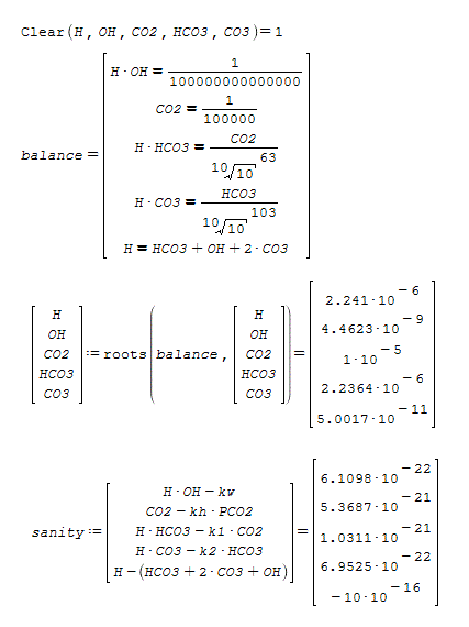

#77 已发布: 2018/7/8 19:48:19
983个赞,共6,866个帖子。
Thanks Radovan, interesting.
Levenberg-Marquardt is one solver, that fails this example.
You can only conclude you have solved if there is a way to
sanity out of doubt. In short, solving is more than some numbers
Solve Given_Find [CO2_6179].sm (38.11 KiB)已下载 1028 次。

#79 已发布: 2018/7/9 10:01:59
983个赞,共6,866个帖子。
You are welcome Jean,
We should not forget roots() which was one of the first functions in SMath of its kind.
Thanks Radovan,
... refreshed/updated both versions.
Solve Given_Find [CO2_6179].sm (36.33 KiB)已下载 981 次。
