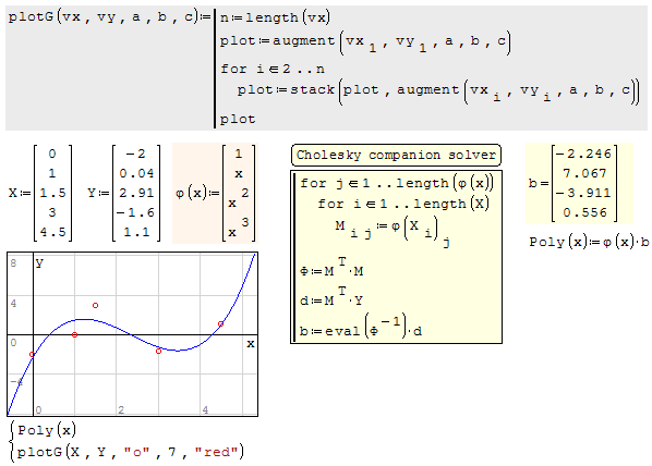

My interest focuses on a method where the number of equations is m, and the number of unknowns is n, with m>n
I'm not aware of such methods, but don't deny such inventions.
Let's leave al_nleqsolve on the side for the moment, and revisit the more common
real life where n data points must be fitted via some of so many existing methods.
Like Radovan mentioned, the methods revert to minimizing the SSD [SumSquareDifferences].
At this point, it is essential to learn about the extraordinary property of the Cholesky
solver, not new but so vividely visible in Smath.
It fits directly Lagrange polynomials on minimized SSD.
For more complicated models, in Smath, the refined fit is iterative Conjugate Gradient.
Please, take the time to read the minimalist introduction 7 documents.
Genfit Rational.sm (55.12 KiB)已下载 1159 次。
Polynomial fit Methods [linfitCheby].sm (42.97 KiB)已下载 994 次。
Genfit Rational Type J_8.sm (57.86 KiB)已下载 1135 次。
PolyFit QUICK.sm (24.91 KiB)已下载 1169 次。
Genfit Kirby_2 [Transmute].sm (41.22 KiB)已下载 1015 次。
Solve al_nleqsolve CSTR.sm (38.78 KiB)已下载 1124 次。
Polynomial fit Methods [ Rational linfit].sm (62.14 KiB)已下载 1037 次。
#110 已发布: 2018/7/17 10:39:38
983个赞,共6,866个帖子。
Look closely at this Curvator, not so easy to fit an overall data set.
In fact, the system is 16 equations for 4 data points.
The derivative adjusts the curvature.
Spline Curvator.sm (27.31 KiB)已下载 1131 次。

#112 已发布: 2018/7/17 20:37:48
1,558个赞,共1,868个帖子。

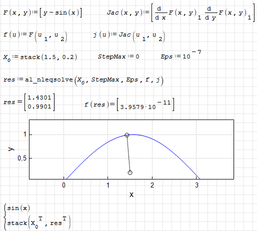

I think that al_nleqsolve() can only solve the system where the number of equations is equal to the number of unknowns
#113 已发布: 2018/7/18 00:10:21
983个赞,共6,866个帖子。
... revisit Cholesky SSD solver.
This version is an adaptive fit, worth the visit.
Polynomial fit_Cholesky.sm (47.84 KiB)已下载 1159 次。

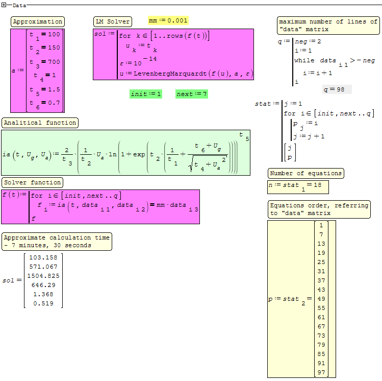

I have insisted on the LM algorithm and I chose three points on each of the different curves represented by the vectors used as data. I wanted to see how far SMath could go by solving a system of nonlinear equations. I have arrived at the system in the image, taking the basis of the first four vectors, namely a1, b1, c1, d1. I have not tried other combinations, for example vectors a1, b1, c1, e1, etc. Under these circumstances, I can say that the results obtained are satisfactory to the good. Based on a 10-point rating system, I would write the result between 7 and 8. What first of all thanks me is that the algorithm could find this solution, starting from a sufficiently remote approximation. With the approximate solution in the picture, the calculation lasted about four and a half minutes. I still do not have the skill to use graphics. I would be glad if someone would recommend examples and tutorials in this regard. For the moment I made the graphical comparisons using the results obtained with SMath in MathCAD. Any equation added to the system in the image leads to errors, including system constraint. I'll continue the tests. Regards.
Nicolas.
LM1_.sm (13.14 KiB)已下载 1163 次。
#115 已发布: 2018/7/22 23:26:16
983个赞,共6,866个帖子。
The model function looks out the blue, at least can't be proved valid.
What do you get from Mathcad ?
If you get better sanity check from Mathcad, then Smath LM is under-designed.
LM1_.sm (35.31 KiB)已下载 1197 次。

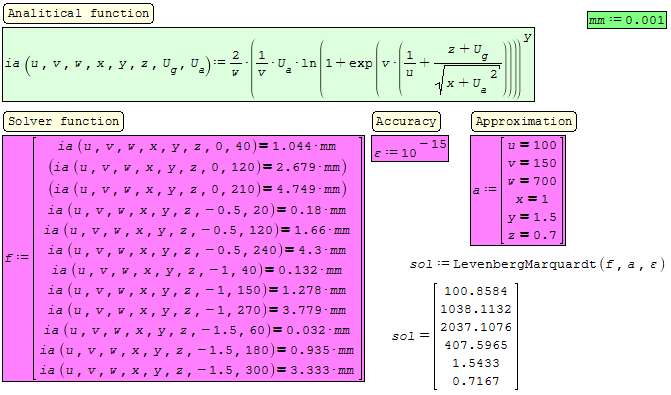

I continued the tests and wanted to see how SMath could lead. I have tried to define the function in a recurring way, as in the attached picture. The first observation was (as in the other test) that for more distant values of the Ug parameter the algorithm gives errors. Then, although I was able to solve a system of 18 equations (even 19 in one of the attempts), the increase of the number over 20 is also accompanied by errors. A sign that the solution is close to reality is the value of the variable from the exponent, which is naturally very close to 1.5. I think the convergence criteria should be strengthened for the LM algorithm in SMath. Although I have succeeded in introducing several equations in the calculation, however, the result of the first test was better. This is because the equations in that case have been selected based on the results already known to me in MathCAD.
... If you get better sanity check from Mathcad, then Smath LM is under-designed.
I did not mean to say that. But just as for the Levenberg-Marquardt algorithm in SMath, there is still room for improvement.
A mathematical program should not only be considered for those with the highest mathematical skills. If you know how many engineers put on the scale just the empirical arguments revealed by the most palpable practice and run away when it comes to math! That's why I consider MathCAD an excellent program for wide categories of professionals. It's easy to drive even for the most inexperienced. I use the method of viewing on the graph rather for checking. I find it easier to compare two graphical curves than two inexpressive vectors. Therefore, being very little experienced in this regard regarding SMath, I preferred a check in MathCAD. Otherwise, all the best.
Nicolas.
LM1__.sm (44.6 KiB)已下载 1147 次。

However, AlgLib Solver works faster and depends little on X0 matrix.See # 29
https://en.smath.info/forum/yaf_topics32_Extensions.aspx
Overdetermined.sm (15.26 KiB)已下载 1310 次。
