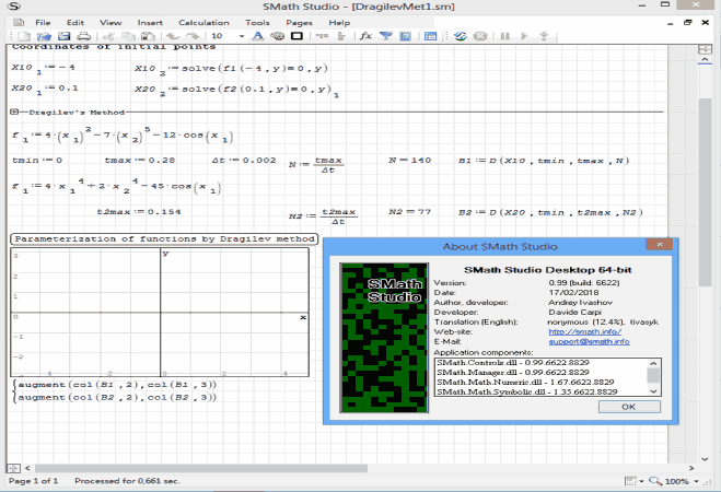

Hola Alvaro, Hello Ber7,
Thanks for your reply, but the DragilevMet2 and 3 files do not work.
The file of Ber 7 does not show any error, but by requiring the value
of B1 and B2, it says that "x" is not defined.
Attached drawing of the errors.

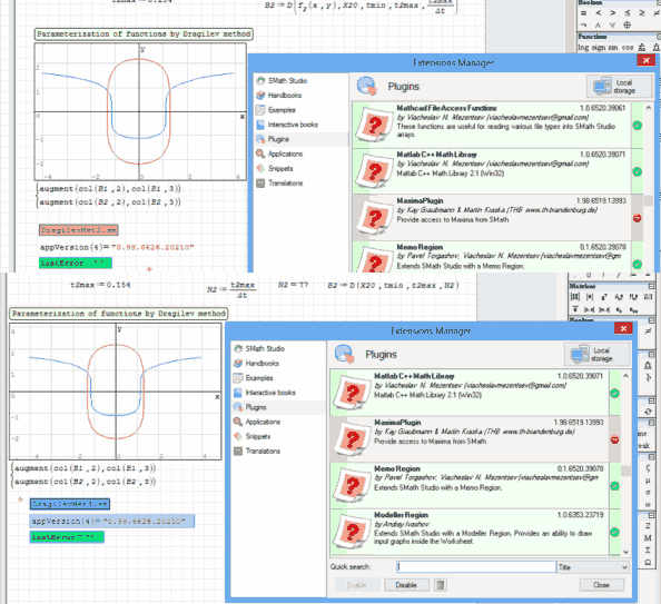

Hello Jean, your files worked perfectly.

Hola Alvaro
Here too, the problem is caused by the decimal separator "Point",
Changing in options, the decimal separator from "Point" to "Comma", (from "." To ",")
resolves the problem of graphing
