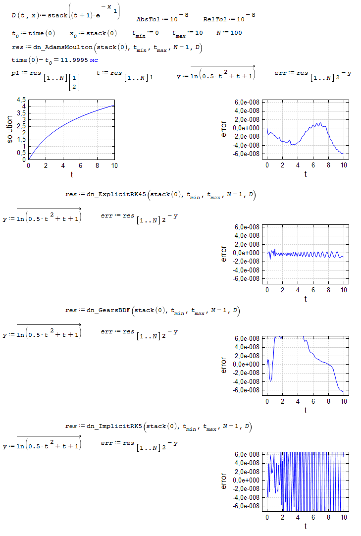

#22 Posted: 2018/8/1 21:57:14
Simple test 2.
Works nice conventional/visual [6179].
That document, if it would come from other designer
would pass my QA [Quality Assurance].
DotNumerics.ode.test2.sm (24.51 KiB) downloaded 1470 time(s).

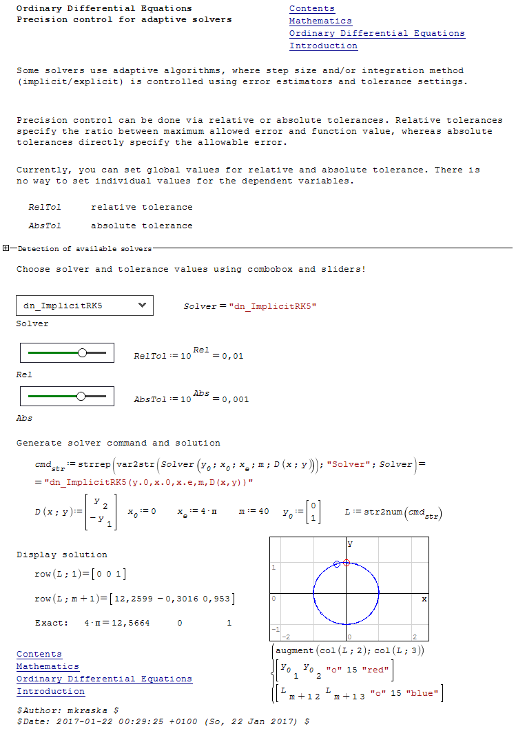

#23 Posted: 2018/9/9 14:23:36
1,353 likes in 2,264 posts.
It seems that all the dotnumeric ode solver functions fail to add the last step to the solution. In the given example, the exact solution is (approximately) met if the end value of x is increased by one step (x_end/steps).
The sheet is easily extended to whatever ode solvers by adding their name to the search list. The actually available solvers depend on what plugins are installed.
Section Math ODE precision.sm (23.66 KiB) downloaded 1514 time(s).
frapuano 2018/9/9 17:18:00, Вячеслав Мезенцев 2018/9/10 05:37:00

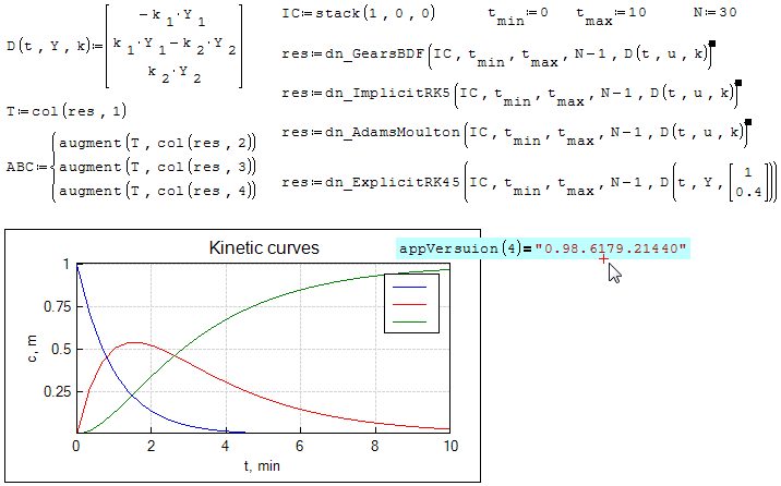

#26 Posted: 2018/12/24 09:13:53
1,544 likes in 1,859 posts.
Updated.
2018-12-24_17-06-48.png 2018-12-25_04-33-23.png 2018-12-25_04-34-24.png dn.ode.test2.png dn.ode.test1.png 2018-12-24_17-07-41.png
dn.ode.kinetic1.sm (8.26 KiB) downloaded 1614 time(s).
dn.ode.kinetic2.sm (12.59 KiB) downloaded 1507 time(s).
dn.ode.kinetic3.sm (12.28 KiB) downloaded 1553 time(s).
dn.ode.test1.sm (19.58 KiB) downloaded 1576 time(s).
dn.ode.test2.sm (18.88 KiB) downloaded 1543 time(s).
dn.ode.Amplitude detector.sm (20.17 KiB) downloaded 1593 time(s).
dn.ode.kinetic1.pdf (77.42 KiB) downloaded 825 time(s).
dn.ode.kinetic2.pdf (93.05 KiB) downloaded 805 time(s).
dn.ode.kinetic3.pdf (91.31 KiB) downloaded 784 time(s).
dn.ode.test1.pdf (115.72 KiB) downloaded 765 time(s).
dn.ode.test2.pdf (120.44 KiB) downloaded 772 time(s).
dn.ode.Amplitude detector.pdf (148.87 KiB) downloaded 787 time(s).
