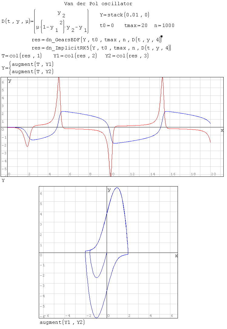

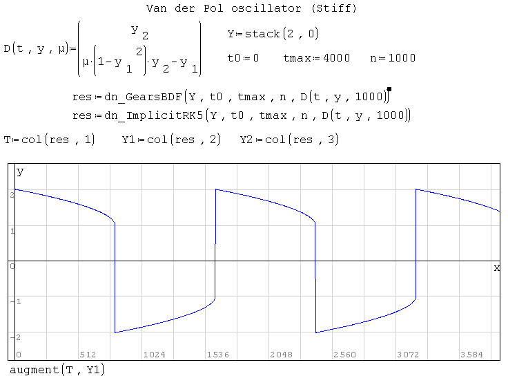

Differential Equations. Initial-value problem for nonstiff and stiff ordinary differential equations ODEs (explicit Runge-Kutta, implicit Runge-Kutta, Gear’s BDF and Adams-Moulton).
Solvers for Non-Stiff Systems:
dn_AdamsMoulton(init, x1, x2, intvls, D) solves an initial-value problem for nonstiff ordinary differential equations using the Adams-Moulton method.
dn_ExplicitRK45(init, x1, x2, intvls, D) solves an initial-value problem for nonstiff ordinary differential equations using the explicit Runge-Kutta method of order (4)5.
Solvers for Stiff Systems:
dn_ImplicitRK5(init, x1, x2, intvls, D) solves an initial-value problem for stiff ordinary differential equations using the implicit Runge-Kutta method of order 5.
dn_GearsBDF(init, x1, x2, intvls, D) solves an initial-value problem for stiff ordinary differential equations using the Gear’s BDF method.

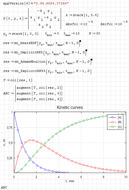

Examples:
Test_GearsBDF.png DotNumerics. Example 3.png DotNumerics. Example 4.png Arenstorf orbit.JPG

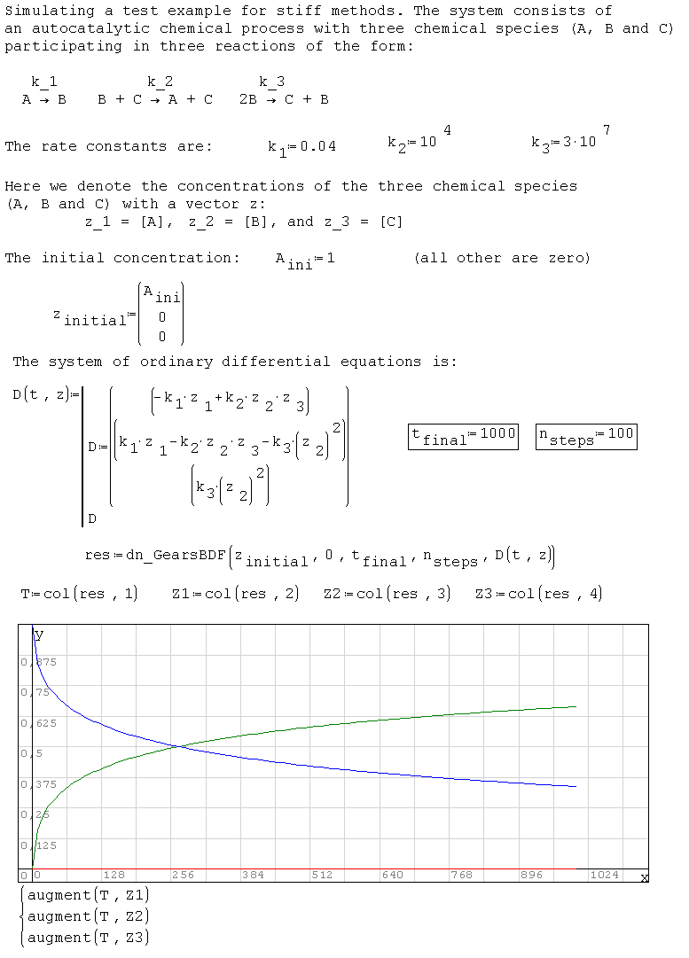

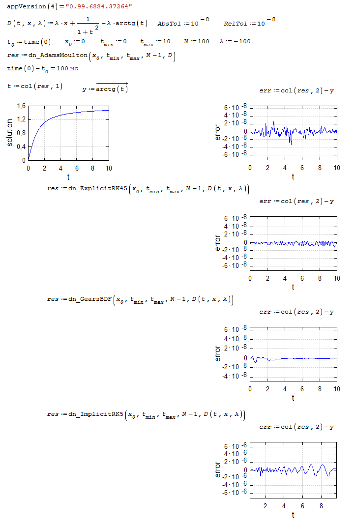

2018-12-24_17-06-48.png 2018-12-25_04-33-23.png 2018-12-25_04-34-24.png dn.ode.test2.png dn.ode.test1.png 2018-12-24_17-07-41.png

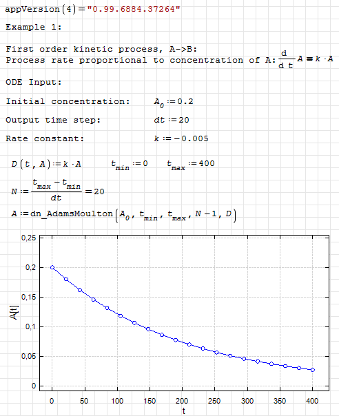

dn.ode.kinetic1.sm (8.26 KiB)已下载 2032 次。

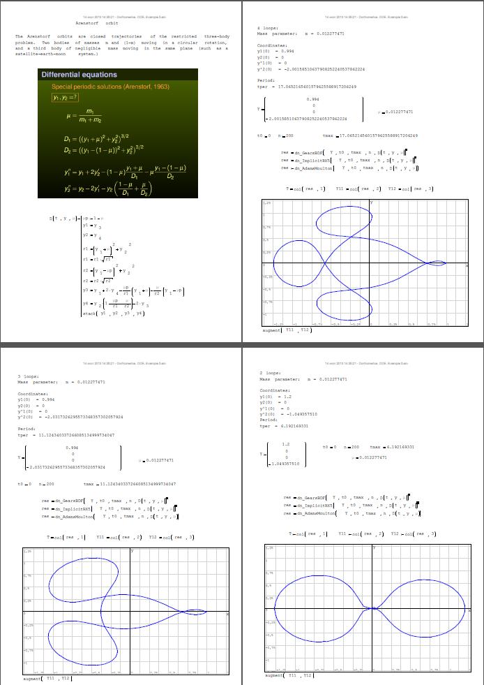

DorNumerics. ODE. Arenstorf orbit.sm (91.95 KiB)已下载 1825 次。

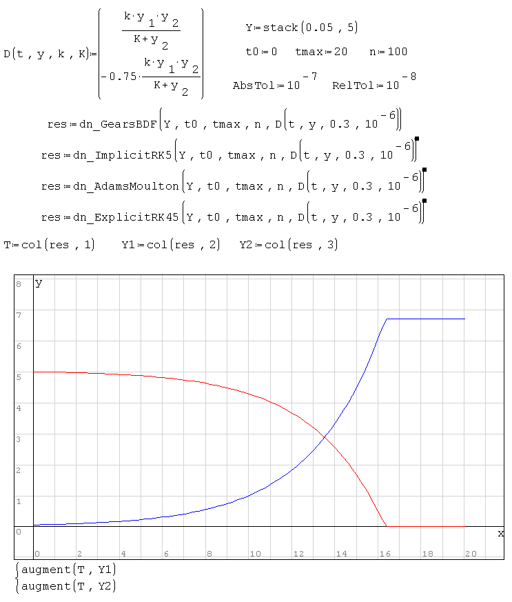

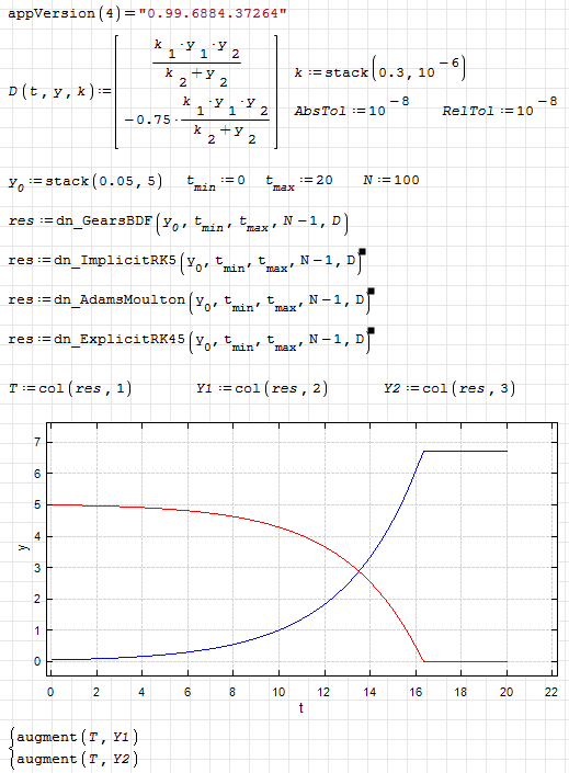

I must be annoying now , but could you try please try to reduce this numbers just a bit and try my "famous" example with bioreactions. I used recently some ODE stiff solvers from a package inside R. They gave the same results with negative concentration. Then, I reduced the default values for the accuracy and it worked a bit longer, but gave me the expected zero concentration.
#10 已发布: 2013/7/14 14:52:57
1,558个赞,共1,868个帖子。
By the way uni,
I am just curious how is the numerical accuracy controlled in all your solvers? There is no any additional parameter about this, or I was wrong about it?.
For all methods the following values​​:
RelTol = 1.0E-4,
AbsTol = 1.0E-7
I will add the ability to change it. I think, using variables in the document: RelTol and AbsTol.
Updated. I've added support for accuracy (not completely). The library allows to set accuracy for each equation separately. Now for all the equations will be the same accuracy.
#11 已发布: 2013/7/14 15:57:40

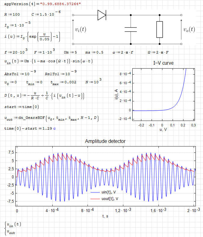

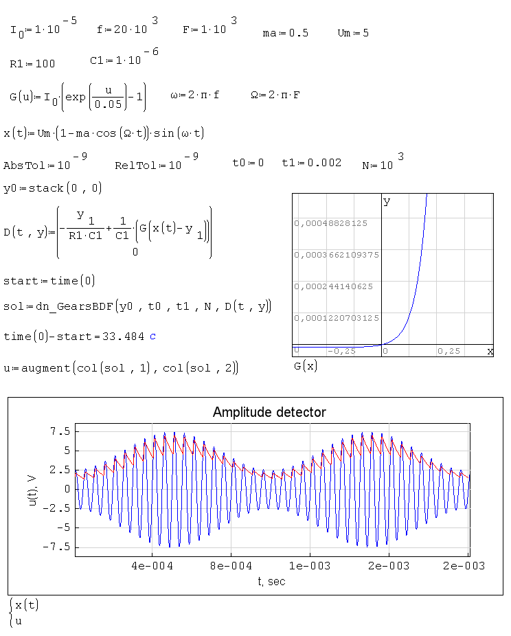

Amplitude detector.
Amplitude detector.sm (14.41 KiB)已下载 1747 次。

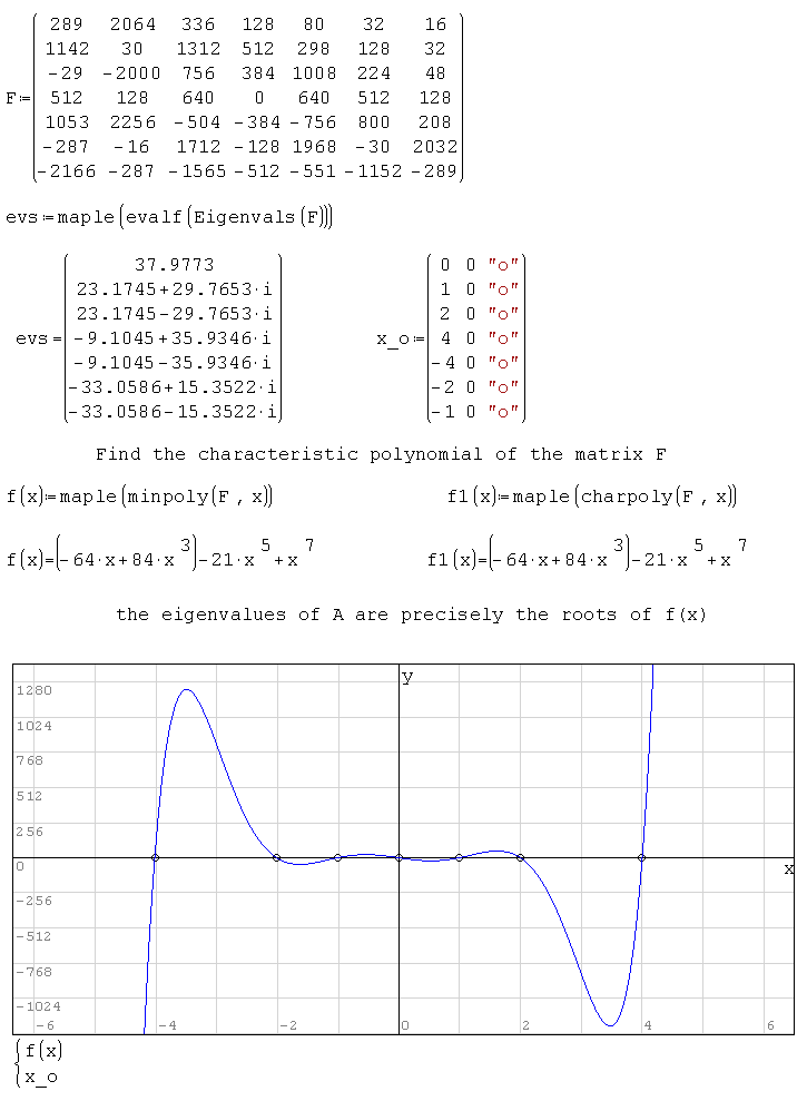

[+]: dn_LinAlgSolve(), dn_LinAlgLLS_COF(), dn_LinAlgLLS_QRorLQ(), dn_LinAlgLLS_SVD(), dn_LinAlgSVD(), dn_LinAlgEigenvalues(), dn_LinAlgEigenvectors(), dn_MatrixInverse().
引用
I have such a modest dream – ta have available in SMath some others modules from DOTNUMERICS, particularly the EISPACK one.
What kind of functions do you need?
I'm not sure that dn_LinAlgEigenvalues() works correctly.
DotNumerics. Linear Algebra. Example 1.sm (28.95 KiB)已下载 1831 次。

Hello uni,
I played a bit with your example. It seems to me that eigenvalues and eigenvectors are correct for both matrices A and F. For the matrice F you gave the vector of eigenvalues which should be correct ("must be" vector). It seems that both vectors of eigenvalues - this one and the one found by dn_LinAlgEigenvalues() correspond to the eigenvectors fond by dn_LinAlgEigenvectors(). I am not sure this should be all right then or some numerical "glitch" is involved here. For some simpler matrices it works Ok and we can get the desired result by simple transformations of eigenvectors. I do not know how the AlgLib works and which kind of transformtion uses in order to give one of the many possible solutions for eigenvectors. I might be wrong about all of this, of course.
This time again eval() must be used as well to get the result. Moreover, again the well known annoying thing that sometimes the results with and without eval() are slightly different. See the attached file please.

#17 已发布: 2013/7/19 04:02:29
1,558个赞,共1,868个帖子。
Yes, this is interesting. And I'm doing it this way.
DotNumerics. Linear Algebra. Example 2.sm (11.82 KiB)已下载 1834 次。

325个赞和1个踩,共2,052个帖子。
Hmm...If you use eigenvals() instead of Eigenvals(), you will get the roots as on the graph. I do not know what is the difference?

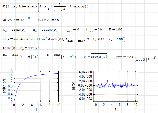

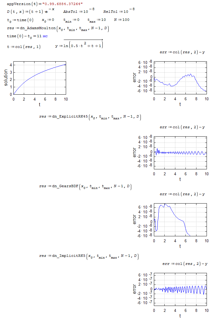

dn_AdamsMoulton simple test 1.
dn_AdamsMoulton.test1.sm (11.33 KiB)已下载 1767 次。
dn_AdamsMoulton.test1.pdf (48.2 KiB)已下载 891 次。
