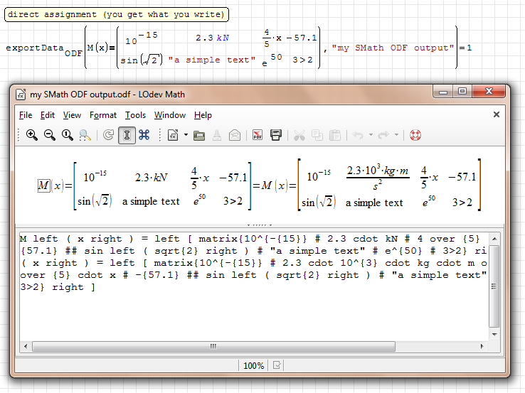

PLUGIN UPDATED
added [MATH lang=eng]exportData.ODF[/MATH] to export data to OpenFormula files.
[edit] when possible, the default output is: formula as defined = symbolical formula (variables replaced with numbers) = numerical output value
direct assignment: data to export written inside [MATH lang=eng]exportData.ODF[/MATH] 1st argument.
best regards,

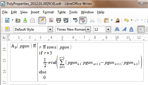

PLUGIN UPDATED
REQUIREMENTS: .NET Framework required version upgraded to 3.5
  • added "Save as" odt files:
    - editable equations;
    - text formatting like SMath worksheet (size, colors, style:bold/italic/underline);
    - page size & orientation like SMath worksheet.
  • added [MATH lang=eng]exportData.XLSX[/MATH] and [MATH lang=eng]importData.XLSX[/MATH]
  • ODF formulas:
    - added: el(3), range(2), range(3), sys(), all trigonometric functions, subscripts, absolute variables (~variable), empty values (#), nested quotes.
    - units: typeset, multiplication symbol;
    - text: added quotes, alignments inside matrices;
    - programming: added line()*, if/else, for(3), for(4), while();
    - booleans: fixed comparision symbols issues;
    - general: fixed conflicts with reserved words and symbols, output markup adjustements.
  • dynamic assistance adapted to multilanguage (ENG/ITA implemented, send me a PM with your translations to have more languages)
  • [MATH lang=eng]exportData.CSV[/MATH] and [MATH lang=eng]exportData.ODS[/MATH] enhanced to export even unassigned variables.
* when there is a variable/function defined with a line(), the right side could be higher than the left side; simply add some #{} after the = sign to pull up the left side.

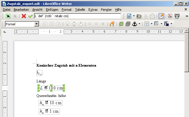

thank you for the odt-export feature, great work! It works really fine and I like the formatting. I observed the following issues:
- Images (from image or plot regions) are shrunk to a small thumbnail when loading exported odt files. The images seem to have the correct resolution and size information, but some odd scaling factors are applied. Once they are reset to 100%, you get the correct size and aspect ratio of the images.
- Word 2010 can read odt files directly. However, it fails to read the files exported by your plugin. Once I read the odt into Libre- or OpenOffice Writer and save it again as odt, then Word can read the file (one has to ignore the annoying complaints about damaged contents). May be, by adjusting the odt format the plugin could gain direct Word connectivity.

Hello w3bsurf3r,
I tried with LibreOffice 3.6
Here are the example files for the image size problem
Zugstab_export.odt is as exported by SMath,
Zugstab_export_LO.odt is as saved by LibreOffice Writer.
I had to zip the files because odt attachments are not allowed in the forum.
Martin

Try the attached DataExchange.dll
images now have the correct size, thank you for the bug fix. Also, direct word read in is possible (zugstab-export-1.odt). However, in this case only images and text regions are read, all math regions (formulas) are broken.
Intermediate load and save with libreoffice (zugstab-export-LO-1.odt) improves the word import, still the formatting of control structures is broken.
In general, opening both odt files with word generates error messages. If saved as docx from Libreoffice, then Word can read the file cleanly, still formatting is broken (mainly due to centering of math items)
Martin
