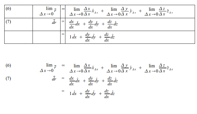

Don't know if this is relevant or how sophisticated you want to be about reformatting stuff, but this thought may be of use. MS word has a facility (as does LO) called tables. When tables are created, each area in the grid is like a mini-page on its own and can be formatted independently of all the others. To align equations, make a 4 column table, put the equals sign (=) in the third column, and narrow the column width to the minimum needed to leave the equals sign visible. Then place equation numbers in the first column, and the LHS and RHS expressions in the second and far right columns. Align the LHS to the right and the RHS to the left. All equals signs and RHS expressions to follow on subsequent lines will be aligned properly.
In the LO file below, tables are used with mathml formula objects in the second and far right columns. Text is used in the first and third columns. This table formatting works in MS office as well. I adjusted the font size of the equals sign until it looked right.

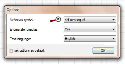

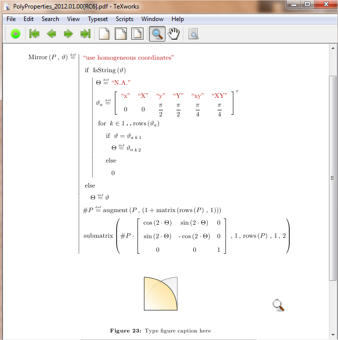

PLUGIN UPDATED
  • added "Save as... > LaTeX Text Document";
  • ODT saving:
    - ouptut ODTs now are compatible with MS word (brackets looks better than saving the file from libreoffice)
    - added options on ODT saving (Save text as images/Save formulas as images/evaluate equations)
    - "Print Area Regions" settings from "Page Setup..."
    - SMath texts on multiple lines now are shown on multiple lines even in the output file.
    - minor changes
  • ODF saving: each evaluation (input formula/symbolic/numeric) written on a different line of code;
  • Embedded languages: ENGLISH/ITALIAN/RUSSIAN

Hello w3bsurf3r,
thanks for updating the plugin. The Latex-export looks great (not yet tested, but your preview looks promising).
Btw, how does one make math expressions (is it latex?) in these forum posts?
Hi rising eagle, It's a good idea but quite complicated to generate undefined levels of nested equations/statements (but I've done something similare for LaTeX, where tables and formulas can be mixed easily).

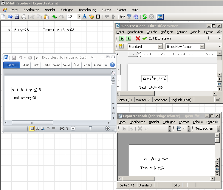

hi DC, thanx for updating plugins
try using plugins, save as ODF/ODT all symbols did not display (except for Pi) since it contains "i" at beginning symbol code in OOo math
and here's display result,
please consider, is this crucial for math? thx u

I cannot reproduce the problem, see image.
It seems like xyonx have removed the standard content of the LO/OOO Math Collection. My system gives the same for %ivartheta.
Generally I prefer to use greek characters themselves (plus usual Math decoration) and avoid using the collection names. This makes greek to look consistent with other text, no need to use special font for greek since most modern unicode fonts support it, and it enables to use several "styles" of formulas (if using collection, I would need to define a full new set for each style). Maybe it's worth it to use unicode greek char codes instead of the %igreeknames?
However, there may be some pitfalls that I haven't met at my setup...

hi ALL, thx for quick reply
maybe it's about office software & language installation compatibility, i'm using Lotus Symphony 3 Release 3.0.1 FP2
btw, i did not find any %i.. code to write symbol in OOo/LO user guide (English version),

i'm not really understand but it's look like the %i.. code required to emphasize italic font in math formula
just asking why the ODF/ODT standard did not consistent in displaying formula content?
#59 已发布: 2013/1/28 17:12:56
1,443个赞,共2,936个帖子。
Thank you, I'll fix it ASAP! [DONE]

Yes, it's possible... [DONE]
- provide choices (if possible with adjustable default settings) for
-- assignment operator (:= vs def over =)
-- equation numbering (starred or unstarred equation environment)
[DONE] (can memorize settings)
