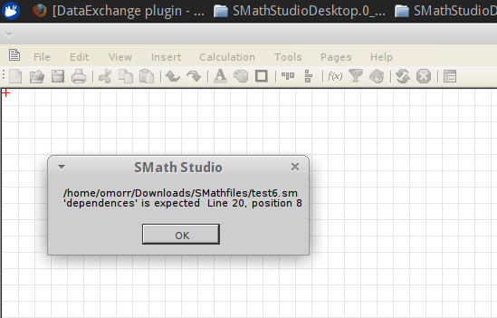

It seems that running SMath in Linux and Mono is quite "an adventure", as you said. I am afraid I can not do to much regarding this, just to try it like a curious ordinary user - nothing else. As a w3b5urf3r_reloaded plugins fan I tried a bit this unofficial portable build (thanking to mkraska). My files I used to test these plugins worked fine. This time I used Xubuntu and found an additional issue (I think) I did not pay to much attention on before (or it might change something in the meantime regarding Xubuntu updates etc.). I did not noted any crashes, only the problem with nonvisible pictures, but I've noted that SMath file can not be safely saved if there are plots and graphs in it. Here are the errors when we try to save a file which includes plots or pictures (first picture), and then when we try to open that file (second picture)- it seems that it is not valid and corrupted. My experience with Linux up to now is: SMath file can be made in Windows, opened in Linux, worked correctly, but can not be saved in Linux if you have plots or pictures in it. I don't have the slightest idea what does it mean and what happened. Moreover, I think that someone already mentioned this corruption things.
Just for the record, here is the file - it seems it stopped at some moment (/dependences tag)
<?xml version="1.0" encoding="utf-8" standalone="yes"?>

      <assembly name="SMath Studio" version="0.95" guid="a37cba83-b69c-4c71-9992-55ff666763bd" />
      <assembly name="Math Region" version="0.95" guid="02f1ab51-215b-466e-a74d-5d8b1cf85e8d" />
      <assembly name="Plot Region" version="1.7.4594.38" guid="c451c2b5-798b-4f08-b9ec-b90963d1ddaa" />
    </d
Martin Kraska 2013/4/20 18:39:00

Radovan, do all the problems also occure if there is no external plugin at all? Can you confirm the stability of the yesterday late night adaptivity patch by Davide? This saved me from maintaining two different distributions. However, half of the zip file size comes from the XLSX I/O feature. The distribution without this feature would fit on a floppy disk (as once Derive did).Martin
The save option regarding plots and pictures has no difference using the official build or compact one you've made. I tried Devide's nonlinear solver functions a bit and I and it works, at least everything I tried.
Regarding DataExcange plugin and compact version there are no crashes.
As I could see, save ODS, and save xeLaTex is working.
Export functions are working, except that I have to put the entire path of the file. If I do not put the path (current directory) then functions reported no errors (1) but I can not find them in the current directory. If I put the entire path then it seems ODS,ODF,CSV export seems to be just fine. It seems that XLSX is not working - it produces error "exportData.XLS(,,,) - function is not defined".
Importing functions are a bit problematic. For ODS there is no success. The file can not be find. If it is in the current directory, it can not be find. If I put the entire path than "Path is empty" error issued. It seems that XLSX is not working either - it produces error "importData.XLS(,,,) - function is not defined".
The same situation is when I put the plugin in the official SMath release.
I tried the recent DataExcange plugin from http://en.smath.info/forum/yaf_postsm9118_DataExchange-plugin.aspx#post9118 that Davide recomended.
As a conclusion of this short test. Save is working, Export is working but thu full path must be used, Import is not working, XSLX I/O is not working
BTW, I am using Xubuntu regular installation - not the Live or Virtualbox one. I could try some other ditros latter.
The current working directory path will be fixed after the next SMath relase; as for now on my Ubuntu it's the home directory. Have you tried to use the "full package" on your Linux distro?
yes, I did try the "full packeage" as well. There is no difference regarding the path. I should use the full path and my home directory is "/home/omorr/". I like your comment which includes "the next SMath release" . As far as I am concerned, SMath under Mono is not so reliable at the moment regarding the behavior of both "ful" or "condensed" versions (as far as I can figure out). I use it on different distros, and the situation on saving problem appeared recently on my Xubuntu. Therefore, I do not know what is the cause of problems - diferent Linux distros, my actual configuration, something else I am not aware of... There are some other annoying things like when you open few SMath files, maximizing is just unavailable sometimes - some of the files are just windowed and can not be maximized. I hope that this will change to a more stable SMath on Linux and I am looking forward to the next SMath release . From my own experience, when the Wine or Mono are included, there is quite a chance that some things will simply not work or have some peculiar behavior sometimes.
Edit: By the way, I think I mentioned this already. This "condensed" version is something I would prefer for my teaching in the first place
