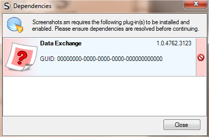

- XLSX features moved away (see Xlsx Import/Export plugin )
- plugin added to the Gallery (Latest Nigthly build)
- Added Guid (after installing the plugin, a message should appear opening old files, just skip it and save again the file)

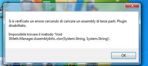

when the program starts, the following message appears
operating system Win 7
smath versione 096 4868
net framework 4.5.1
#118 已发布: 2013/12/30 09:47:42
1,443个赞,共2,936个帖子。
Hi Paolo,
I can't reproduce your issue (win7 x64 - SMath 0.96.4909)
Are you sure that this plugin cause the issue? copy and paste the red string ( %APPDATA%\smath\extensions\plugins ) in your windows start menu, press the return key and then delete the plugin folder (5dce7298-9e5f-4120-9a2e-49b16daa02a3) then try to start SMath again.
Davide
#119 已发布: 2013/12/30 15:11:25
paolo1963
paolo1963
1个赞,共4个帖子。
I uninstalled the version of SMath 096 4868 and I installed version 096 4909 now the program starts.

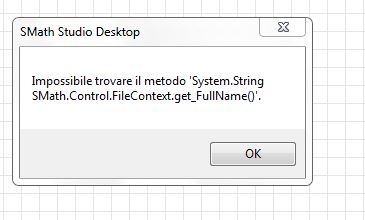

Save in *. odt work,
while saving in *. tex from the following error message:
#120 已发布: 2014/1/3 20:56:45
1,443个赞,共2,936个帖子。
Really strange, I can't reproduce this issue
The problem is related to some worksheet (empty file, with figures, with text, with math), some machine, or is general?
Have you the same issues with the unofficial portable version?

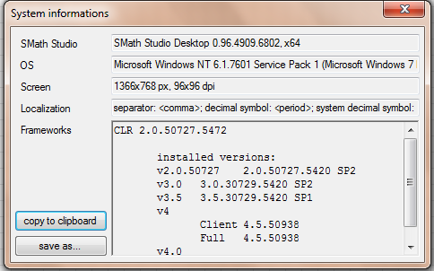

You could try to share here your system informations (Development Tools plugin > System informations > save as... > attach here the file)
