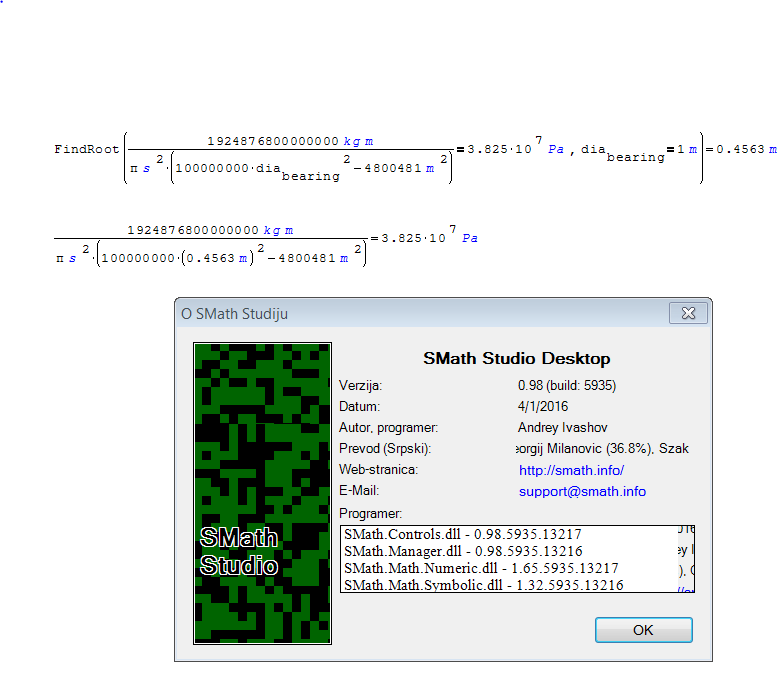

Hello Davide,
I am somewhat confused why FindRoot() cannot solve this equation. Am I doing something incorrectly?
It works just fine for some other equations..
Thanks!
FindRootCannotSolve.sm (4.59 KiB)已下载 1534 次。
#166 已发布: 2016/4/7 16:10:06
1,443个赞,共2,936个帖子。
Hello Alex,
I cannot reproduce... do you have Maxima or some other plugin that may cause the issue?
#167 已发布: 2016/4/7 16:18:09
325个赞和1个踩,共2,052个帖子。
It works for me. The same was mentioned some time ago here. It seems that some plugin is making trouble. I do not know which one.
#168 已发布: 2016/4/7 17:03:40
Alexander O. Melnik
Alexander O. Melnik
127个赞,共498个帖子。
Omorr, Davide:
- Uninstalling Maxima plugin did nothing
- Clean install of stable 0.98 SMath Studio solved the issue. Now I just need to find what other plugin is wreaking havoc there..
Thank you

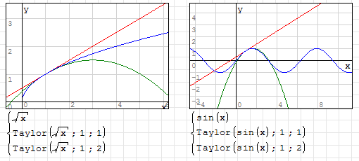

#178 已发布: 2016/9/9 17:39:24
983个赞,共6,866个帖子。
As it looks Martin, "Taylor" is by default.
#179 已发布: 2016/9/9 18:54:26
1,443个赞,共2,936个帖子。
The Taylor() function throws the error message "Specify variable"
How am I expected to do this?
You assigned a wrong value for the 2nd argument, "2:variable".
#180 已发布: 2016/9/9 20:15:05
1,362个赞,共2,276个帖子。
Hm, don't understand. For univariate expressions, the second argument is the development point.
For multivariate expressions, I would expect that I have to specify the independent variable and the development point.
In Maxima (not working in newer versions of SMath) it looks like this:
With your Taylor, I have this:
Sorry, I don't understand the result.
Analysis.sm (28.83 KiB)已下载 1622 次。
