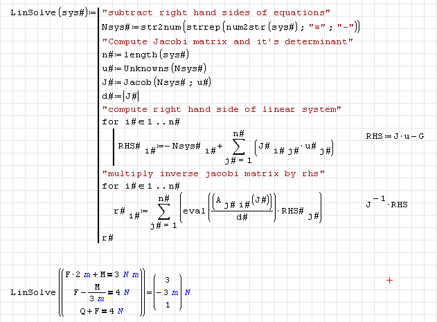

Here is a proposal for a unit-proof and user-friendly linear solver.
Davide, I propose to include it in the NonLinearSolvers plugin, perhaps as FindRoot(1).
- Equations can be specified using boolean equal with arbitrary distribution of linear and absolute terms to left and right hand side
- equations and unknowns can have arbitrary and different units
- no need for initial guess
- no need for specification of result units
I was not able to reproduce the embedded assignment feature in the example procedure. I would propose to enable that by default and perhaps provide an optional assignment flag.
Also, a linearity check (e.g. hessian-based) might be sensible.
The procedure LinSolve() looks more cumbersome than it ought to be, because of unreliable symbolic matrix inversion and multiplication. Fortunately, the alg() function works and thus the inverse can be computed with moderate coding effort.
LinSolve() provides an alternative for "hand made" sparse linear systems, as they typically occure in basic engineering mechanics. For densly populated systems, the matrix notation of the system might be more appropriate.

#144 已发布: 2013/8/5 00:47:12
Janusz
Janusz
7个赞,共48个帖子。
Martin!
Thank you for your perfect work and bright examples. This function will be very helpful for us when it will be included to the plugin.
The best regards,
Janusz
I agree with you completely . Your solution is quite educative and very interesting. A linear solver of this kind would be rather appreciated. We are also aware of unreliable Jacobian (derivatives) calculation, matrix inverse etc. Nevertheless, classical nonlinear solver approach could stuck if you give the linear system and try to force it in a nonlinear fashion. I suppose that you gave the idea to Davide how to make a basically linear solver. I just would like if there would be a possibility to incorporate into the solvers some kind of linearity check, like you said, and the option to solve it as a linear problem.

Your solution could be of certain practical interest (!?).
Linking this topic (of linear solvers) with that of non linear solvers is not the best way of dealing the subject, in my opinion.
Using SMat for sparse matrix linear solvers seems attractive for me.
The only reason why I posted the issue here is that I see the proposed linear solver as a special case of the findroot function in the nonlinear solvers plugin. I am very happy with the user interface of this solver, in particular
- the flexible way to specify the equations (in close to natural notation)
- unrestricted use of units
- and the embedded assignment, which allows me to display and use the unknowns as soon as the solver was called, without any post-processing.
It is just laziness that I do not want to specify initial guesses when that should not be necessary.
With the term "sparse matrix solver" I had in mind just moderate systems with hand-written equations, let's say e.g. equilibrium conditions next to free body diagrams.
Some numeric libraries (like ITPACK) provide dedicated solvers for sparse matrices with elaborate storage techniques. This issue is by no way related to my proposal.
However, I would not mind the moderators to shift the discussion to a separate topic. For the time being I hope for ruthless testing of the proposed algorithm.

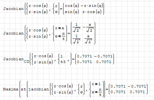

Jacobian.CD seems to be unstable.
Davide, do you have any valid test or demo file, describing the expected functions?
#160 已发布: 2013/12/3 08:48:22
1,443个赞,共2,936个帖子。
Thank you Martin,
you are right, I'll try to fix it...
