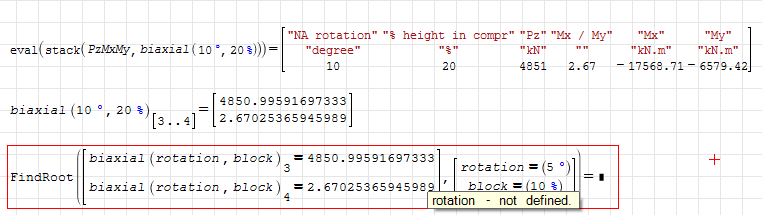

Hello SMath Community, need some help with findroot() function.
I wrote a formula (biaxial bending in a column) to calculate unknown input loads based on known response. A key to practical use of the formula is to solve for unknown response based on known input loads (backwards of what formula does). When using findroot() for this purpose i run into error:
FidRoot-CustomFormulaSolution.sm (537.63 KiB)已下载 1741 次。
What am i doing wrong?
Thanks!
#228 已发布: 2018/4/13 13:36:36
1,443个赞,共2,936个帖子。
FindRoot, as well as other solvers of NS plugin, is not friend of eval, if/else or in general anything that requires a strict numerical evalution to be performed... that's a thing I'm working on (long overdue, I know...)

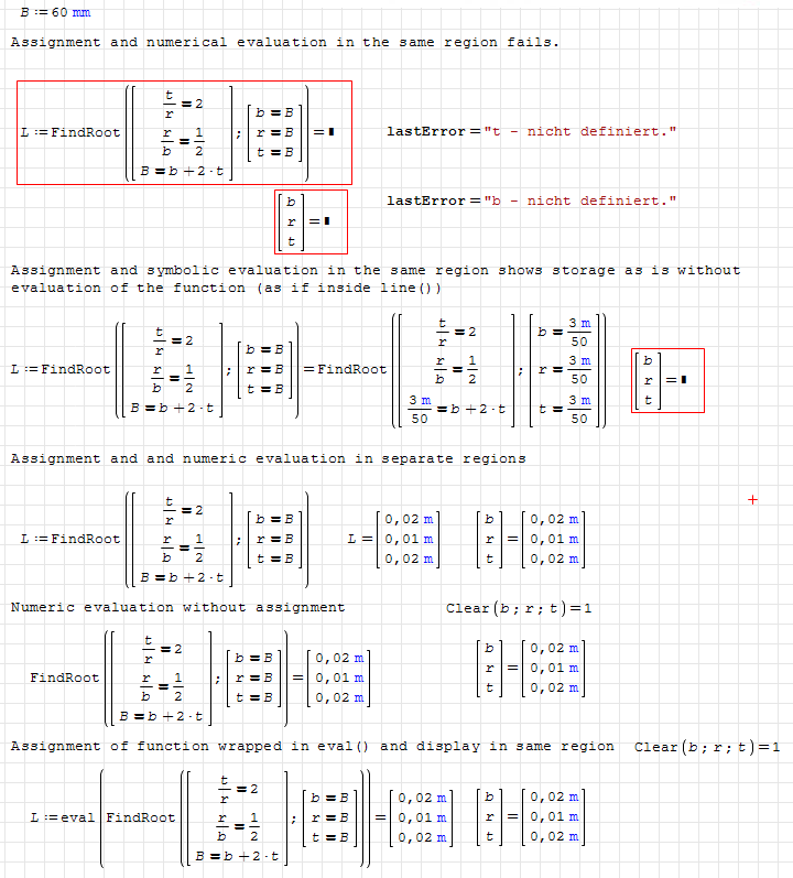

I don't know when these changes happened but my current observation of Findroot's behaviour seems to be different from earlier versions:
  • Just evaluate: displays result vector and executes embedded assignment
  • Assign and evaluate in the same region: Error (symbolic evaluation reveals that the expression isn't executed but just stored as if it was inside line())
  • Assign and evaluate in separate regions: displays result vector and executes embedded assignment upon display.
  • Assign wrapped in eval() and evaluate in the same region: displays result vector and executes embedded assignment (here, eval() seems to be a friend of FindRoot())
In the sheet below I tried to demonstrate how to solve a system of equations using FindRoot() as alternative to Solve(). However, I am not sure how to explain the behaviour to the students. Should we generally avoid assignment with integrated evaluation for the time being?
Yes, they should be avoided. There are several known issues while using implicit assignments, I plan to remove them when I'll have the possibility to commit a major update to this plugin.
Moreover now SMath Studio supports multiple assignments by matrices on LHS, therefore it shouldn't be a big loss.
Perhaps I wasn't clear enough. My example doesn't show any problem with embedded/implicit assignment (at least nothing obvious). What I mean is if you write an assignment with := and in the same region ask for display by = . This one seems to be a problem. Maybe, the two features are related, I don't know.
If you drop integrated/implicit assignment, perhaps would be a good idea to return a set of boolean equations which can be used with at(), just like with Solve(). Then you can easily operate with multiple solutions without having to clear inbetween.

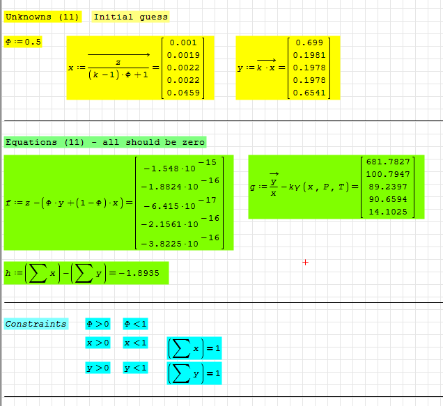

Thank you Jeaan for your efforts, but I think we do not understand each other. This is not a fitting problem but finding roots of nonlinear system of equations
The solution was found in Mathcad - this post - and some other software but never in SMath

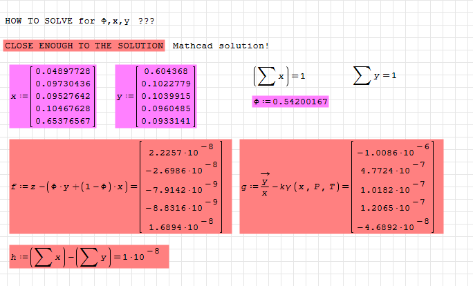

Here is the same problem solved in Mathcad
Hi. Can you show the guess values for x and y? And k before Find too. I get a very different k value. Remember that for numerical procedures, guess values are part of the solution, not of the problem.
Thanks in advance.
Thanks in advance.
Thank you Alvaro for your interest in these problems. Here is the file once more.
Primer38-doomed1.sm (31.96 KiB)已下载 1662 次。
This is a system of nonlinear algebraic equations. If one takes a look at the calculation here it is obvious that any gradient algorithm for solving this system will fail. Therefore, some non-gradient method might solve this (direct solving or some minimization procedure). There are some functions in the NonlinearSolvers plugin, but unfortunately, there is no update of them for a long time and many of them do not work anymore. All of these years I mentioned that we need here some well tested and robust library incorporated in SMath regarding these problems. There are no other plugins which will address these problems (AFAIK) and I am not sure that will ever be any.

1. You seem not happy of the result by plugging [x, y] from the other software.
Did you enter enough decimals ? or that software is short of more ?
2. The Smath FindRoots is not robust in there but it can reproduce results
from your source software with more decimals that you collected.
3. Presumably the software is Matlab ?
4. In short: for a fixed Phi, you are attempting to solve pairwise [x,y]
as you scan over 'z'. Isn't true that any pairwise [x,y] will find a valid
solution or closely ? Stated otherwise: the unique non trivial pair [x,y]
is extremely sensitive to initials. That reminds me the Mathcad rootScanner
that I designed for some extremely sensitive initials. But that one tool
is only for one variable.
Cheers Radovan ... Jean
Primer38-doomed1[Solve paiWise].sm (10.31 KiB)已下载 1490 次。

325个赞和1个踩,共2,052个帖子。
Hello Jean,
The solution is from Mathcad (Given/Find)
With an increased number of decimals.
#240 已发布: 2019/2/11 22:45:36
