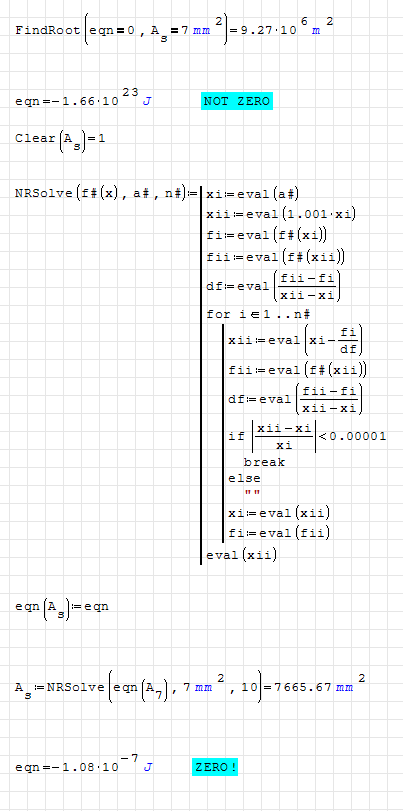

Here is an unforunate example of FindRoot() being unable to solve a problems with units... While my very quick NR Line() solver works just fine.
I wonder if we run into max + number problem or devision by zero.
Hoping for a fix!

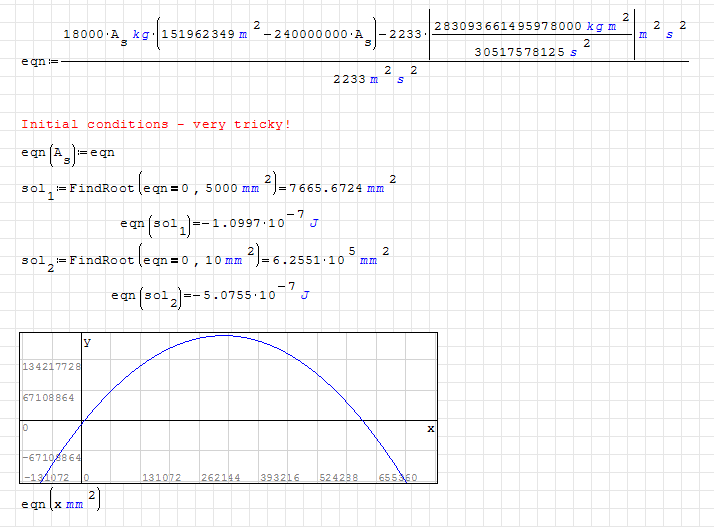

Actually, it could be done - but setting the initial conditions for FindRoot() could be very troublesome for this example.
Initial conditions are chosen just on trial and error, and the calculation can diverge easily by slight changing of IC.
This is basically a second order polynomial having two solutions.

Is there a reason why solver would gravitate to wards a solution further from initial guess? If it were just to follow the slope at the initial guess value it would arrive to the closer, and in my case correct, solution
So far in my expirience it is almost always possible to make FindRoot() solve by substituting just the right value. There has to be a reaon why the function tends to overshoot nearest solution by so much. Also when it does not find a desired solution, the number it spits out is not always a mathematical solution either

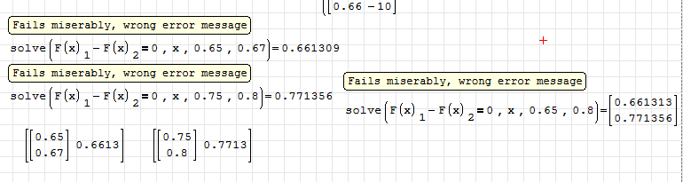

Just for the record (especially for Davide) FindRooot() just does not work in the recent SMath for few of your examples with the error like in the picture. Actaually, it does work when you change the IC from zero to some other values.

That's not a bug Radovan:
=>...For the free finding solutions, IC must be either 0 or 1
[1 to releive from "divide by zero"]<= ... {previous message}
Maybe you are not up to date vs Davide ?
