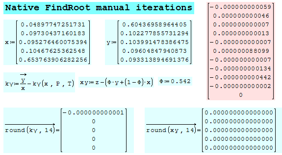

FindRoot works fine manual patience, but could not make work in forloop.
As done, it saturates @ 12 decimals with the two degree of freedom.

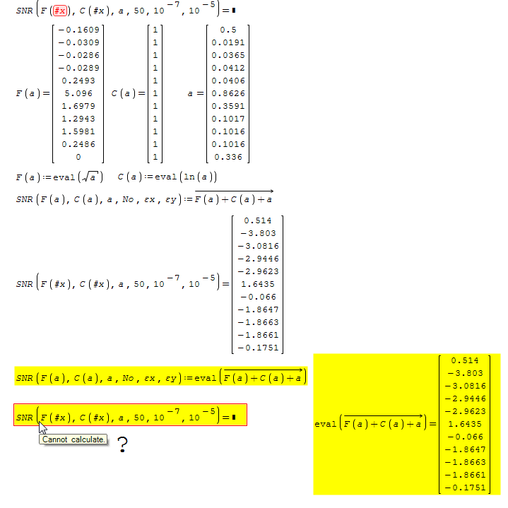

Hi. The troubles that I find solving this is that can't use the normal call for functions, as it is showed at the end, where fails to call the same Newton-Raphson code, but with F(1) and C(1).
This must to be some kind of bug calling functions when the definition of the functions it's complicate or implies the vectorization for the args.

of descending the FindRoot that needs several iterations as it is ± 3 decimals
from the Smath native module. I get 0.0000000000001 as final sanity solutions.
Takes ~ 5 minutes of manual iterations ... Jean is happy !

That version is refreshed in 8 manual iterations, easy to use.
Start by the very initials [xo, yo]
Project Solve Flashing Copy.sm (209.05 KiB)已下载 1686 次。

Thank you Alvaro for this. This was a logical thing to do in order to improve your function. Moreover, the "spooky" thing "xx-not defined" appears here and there and I often do not have a clue why. It often appears when you want to use eval(). Someone might have an explanation for this effect you represented in this example, but it still makes me confused and it seems it will remain that way. I suppose you understand now why I called this one as "doomed".
"can't calculate spooky" because like Mathcad, can't trace back
in the program [generally]. The other spooky about FindRoot
"can't find variables ... try a more specific algorithm "
Often, we get red spooky like you show but calculations are done.
Just adapt a bit of coding to calm down SS from complaining.
Simply spooky syntax as you show.

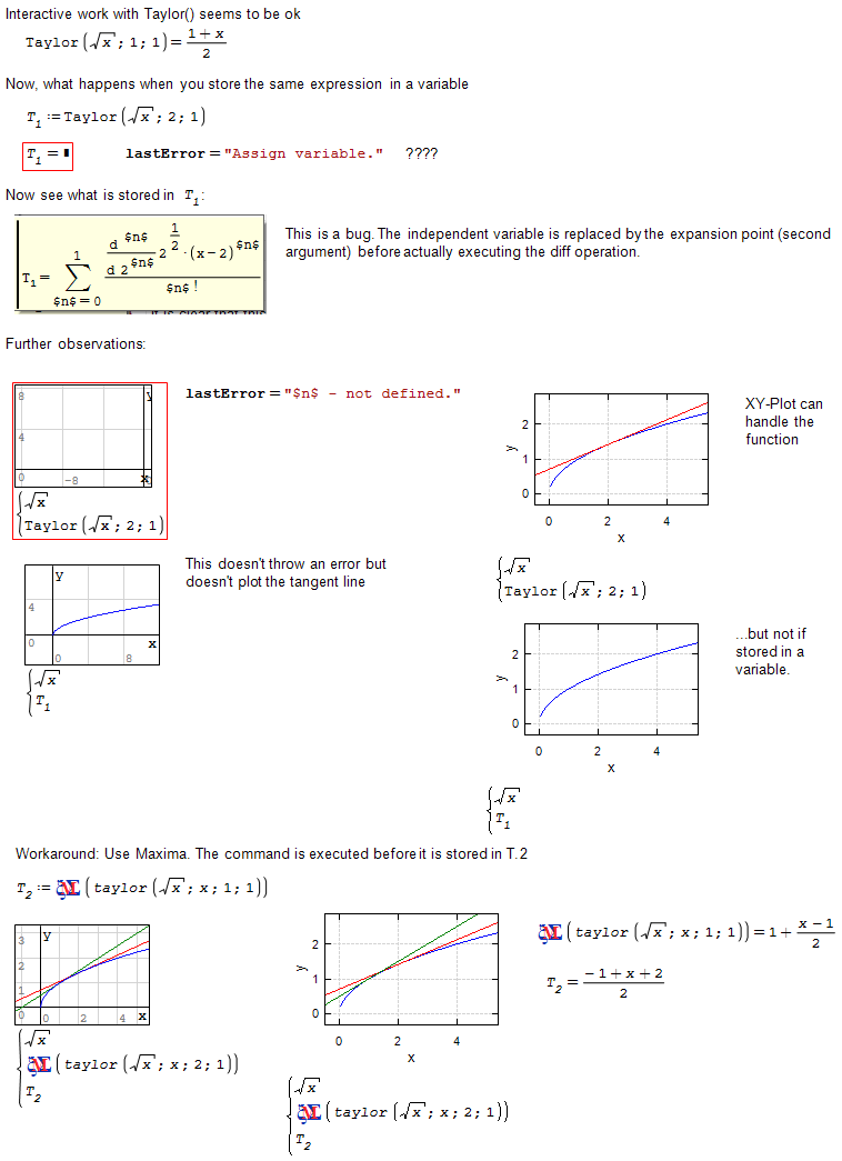

In build 7251, there is a problem with Taylor(), see screenshot. Bugreport filed as SS-4631
Taylor.sm (21.59 KiB)已下载 1610 次。

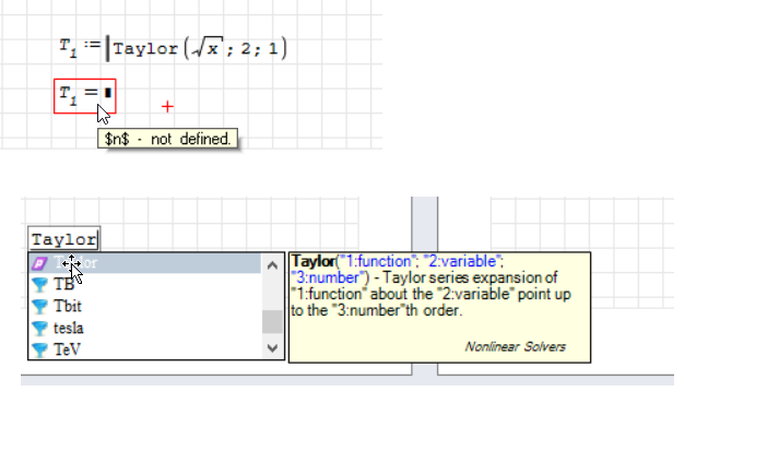

I encountered the bug as well in the latest version (build 8253) with plugin version 1.1.7097.23301, and as far as I can see, the latest update is from 2019: https://en.smath.com/view/618b7e96-330a-406a-b055-9e577672f0b8/summary
Is this plugin still being maintained, or should I look for another solution?
Thanks in advance!

However, I cannot reproduce the workaround.
I also thought the 2nd argument was supposed to be 'x', the variable of the function, but you use '2'? Do I have a wrong understanding?
Thanks again.

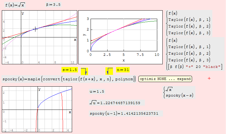

As far as Taylor is concerned, there is no bug in Smath.
Taylor is not a function. Simply a Classroom quick plot demo.
What it plots is not otherwise possible to evaluate.
However, you can play/productive with the spooky Taylor.
Cheers ... Jean ... hope it clarifies.
The missing document.
Maths Taylor Spooky.sm (20.43 KiB)已下载 1657 次。
