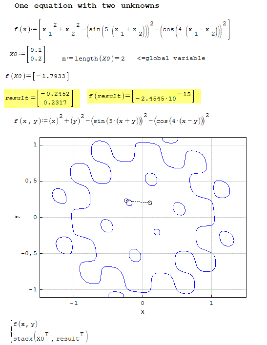

Fortunately, I was wrong. We could use it with different number of equations and unknowns.
I just use the Ber7 example and change it with n as a global variable. No need for zeros as non-existing functions.
Primer%20Uni-mod.sm (13.3 KiB)已下载 1740 次。

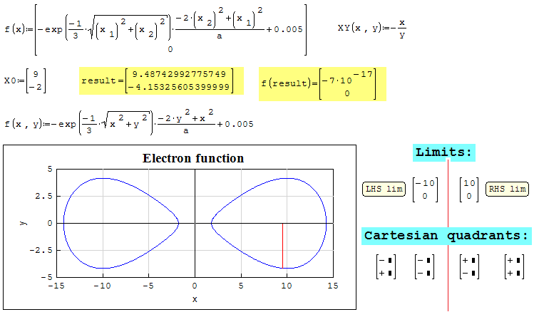

But for some reason simple Newton-Raphson with variable step usually
works better than al_nleqsolve.
Can you demonstrate for this application ?
Solve al_nleqsolve-Electron.sm (18.41 KiB)已下载 1645 次。

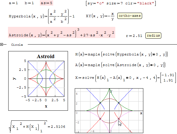

... thanks Ber7
Contour SOLVE AstroidHyperbola.sm (20.85 KiB)已下载 1697 次。

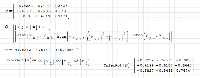

PD: Do you know the angles for your rotation matrix gamma? I get this, but can't put the matrix elements in the correct order nor sign:
Actually, as I know, the minus in the last atan is a mistake, but at least give the same absolute values.

Hi. The same, but without plugins.
Hi, Alvaro.
Unfortunately, I have never done reverse transformations (gamma-omega).
Your error may be caused by the use of the left coordinate system in Smath- graphs.
I selected the angles for the axial matrices empirically in order to get a good perspective ,using the gamma matrix.perspective.
Alvaro 2018/10/9 21:14:00
#39 已发布: 2018/10/10 00:40:38
983个赞,共6,866个帖子。
Mathcad solves the Euler angles from a given γ [gamma matrix].
Smath does not immediately, it complains: Try to use a more specific algorithm.
There are 24 [4!] possible ways to define a 3D system [Mathematica].
The most common is Euler though Mathcad Mathcad ≠ Mathematica.
For common use to define some pleasant views, especially in Smath:
1. Euler [ 3 trig angles]
2. Parametric [X,Y,Z,t] very easy to manage.
3. Quaternion only two coefficients that Quaternion solves for the 3D γ matrix
Rotate Horn.sm (15.07 KiB)已下载 1636 次。

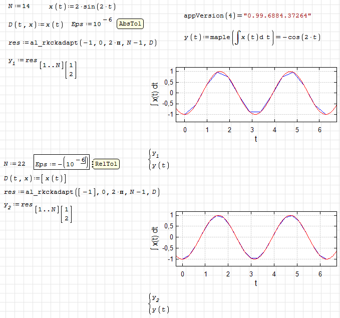

1,558个赞,共1,868个帖子。
Updated.
Changes for al_rkckadapt():
- zero point issue fixed;
- added support for the simple D(t,x) definition.
