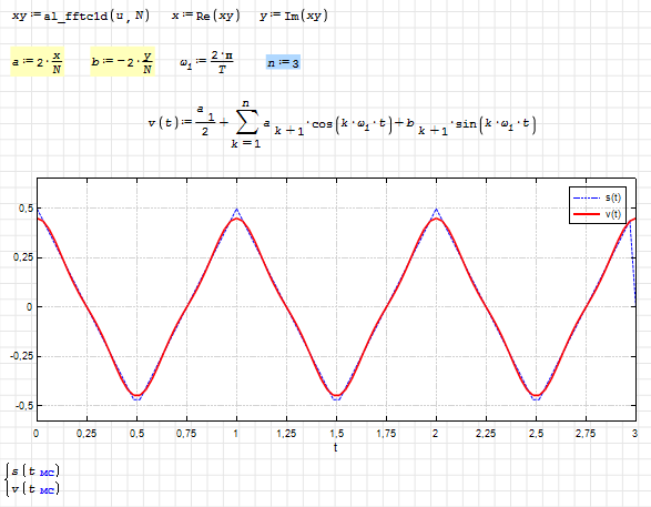

With numeric optimization (for all functions) it works much faster.
Fourier series coefficients.sm (17.54 KiB)已下载 1802 次。
Fourier series coefficients.pdf (138.41 KiB)已下载 1074 次。

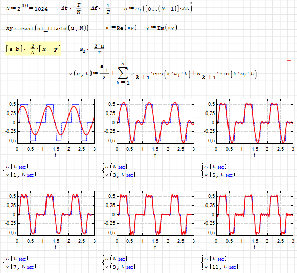

Example 2.
Fourier series coefficients.sm (28.46 KiB)已下载 1936 次。
Fourier series coefficients.pdf (170.26 KiB)已下载 1227 次。

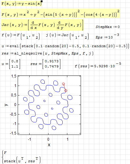

Parameterization of implicit functions with al_nleqsolve
Parametrisation.sm (29.88 KiB)已下载 1831 次。

Hi Ber. Nice technique, easy to implement. You can also make that as a function, and monocolor too.
Parametrisation.sm (25.37 KiB)已下载 1769 次。
Another option could be use y0 as vector, and solve for each element in y0, obtaining res, res1, ..., resn
