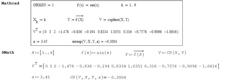

CS only do what mathcad's cspline do:

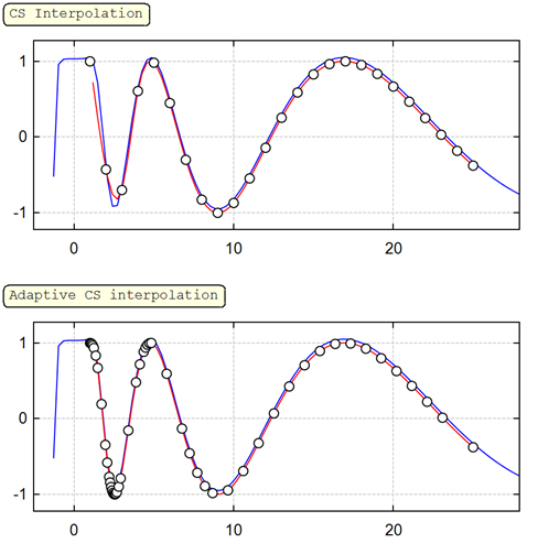

WroteHi Jean. There are not to much shadow in that small code. It's just the implementation of the traditional spline interpolation. In SMath there are not, or I can't found, the function cspline. The interpolation with cinterp in SMath evaluates the vector V each time that you call it, it's always better to have V=cspline(X,Y) and then call interp(V,X,Y,x). Finally, I want to implement an adaptive step size for the intervals in X. But first I see very convenient to have vectorization and plotting issues solved.
CS only does what Mathcad's cspline does:

3. For the adaptive step size, you may have to invent the wheel or implement
Robert A. [Lagrange quadratic knots ... stricking example attached].

adapt cspline test.sm (83.25 KiB) downloaded 1046 time(s).

This worksheet is about adaptive csplines and differentiation and integration of the splines.
