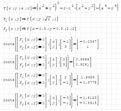

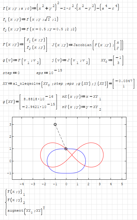

I cannot use the roots function and must use one old good simple method by Newton.
What can you say about it?

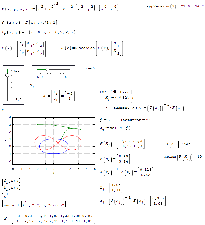

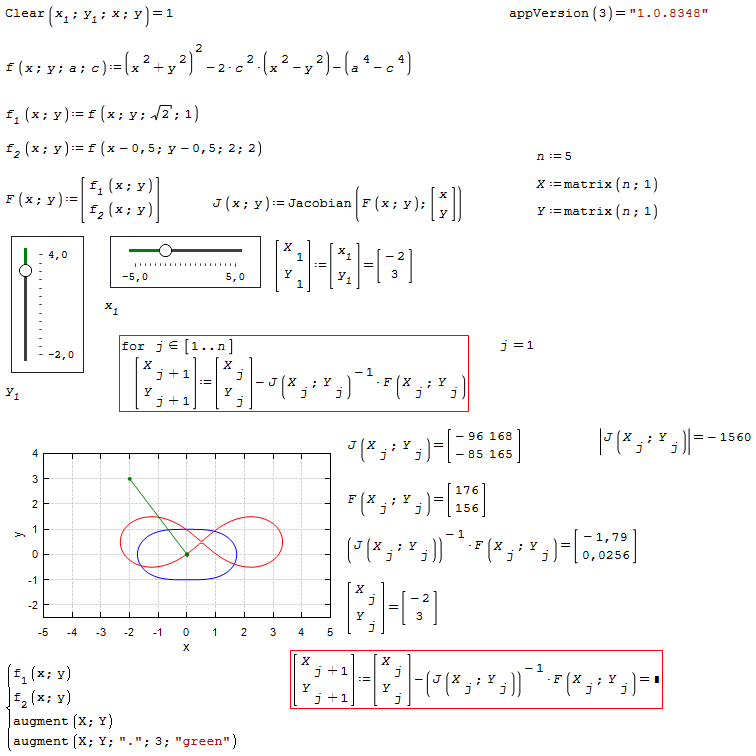

Martin Kraska 2023/4/9 08:50:00
Very nice.
I had problems when reproducing your 2D version. Depending on initial guess I got errors "requested matrix element does not exist". The situation seemed to improve a little by pre-allocating the vectors X and Y yet it didn't become really robust.
So instead of assigning to j+1 elements I used augment() to add new points to the iteration history.
This is the original version:
Newton2D.sm (21.4 KiB) downloaded 1233 time(s).
And this is the modified version.
Newton2Da.sm (19.03 KiB) downloaded 1329 time(s).

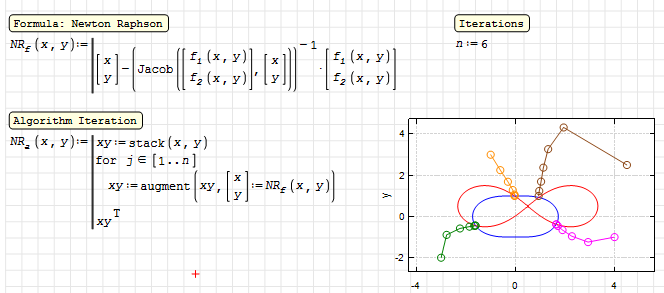

Two variations added.
Newton2Da. v2.sm (38.35 KiB) downloaded 1331 time(s).
Newton2Da. v2.pdf (152.11 KiB) downloaded 793 time(s).
