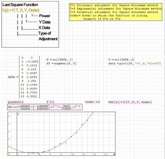

Another example of curve fitting by the least squares method
with option to select the power of the polynomial, or
select the adjustment of the curve to exponential or potential.

WroteAnother example of curve fitting by the least squares method

Hola Jean
Here you have a version in 6179 of the work sheet
of the method of adjustment of curves by least squares
Ajust_by_Last_Square_Selection_Jean_V6179.sm (52.77 KiB)已下载 1475 次。
