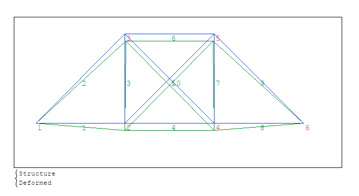

Here is FEMTRuss, my own version of truss calculus via FEM.
I'll check your work, please you check mine
FEMTruss.sm (49.06 KiB) downloaded 1197 time(s).

So far results look good. Great work!

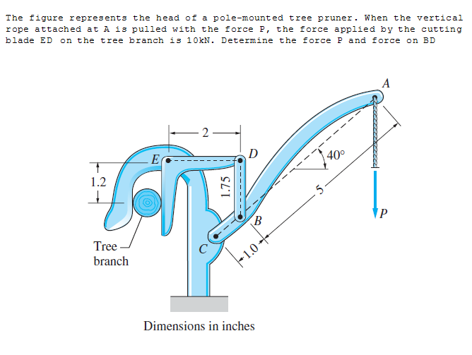

A little example solved by FEM...
P4-118 Pytel modified.sm (165.01 KiB) downloaded 1186 time(s).
