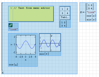

#164 已发布: 2023/4/29 04:39:57
1,558个赞,共1,868个帖子。
Theoretically, I can get data from any component. I can try to get the text from the text region.
Alvaro 2023/4/29 08:26:00
#165 已发布: 2023/4/29 08:31:27
1,139个赞,共1,805个帖子。
Theoretically, I can get data from any component. I can try to get the text from the text region....
Amazing: That's true for a lot of components! What about to catch the text in your memo editor instead SMath's text regions? Or both, I don't know.
#166 已发布: 2023/4/29 08:52:55
1,558个赞,共1,868个帖子。
It's funny, I haven't tried it. I want to simplify the input of text programs. This is another way to extend the functionality of the program through third-party libraries.
A lot of useful libraries have been developed now. There is no point in repeating all this. It is necessary to create flexible interfaces for their integration and interaction with each other.
Alvaro 2023/4/29 09:32:00
#167 已发布: 2023/4/29 09:39:33
1,139个赞,共1,805个帖子。
... I want to simplify the input of text programs. ...
Yep. It would be very practical to have a tool to capture text to process it. I try to use description() function, but it has the drawback that it must be called at the worksheet level and it doesn't work well within the body of a function. Like in chess, RPN, Code or XYOptions.

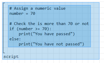

Click to enlarge
maple-system-python-TextRegion.sm (5.58 KiB)已下载 1702 次。
2位用户喜欢此帖子

1,558个赞,共1,868个帖子。
SMath Studio compatibility
Plugin updated.
Changes:
- MathcadBlock: added support for function definition.
Now the function definition can be written directly in the block.
Click to enlarge
maple-system-execute.sm (8.08 KiB)已下载 1787 次。

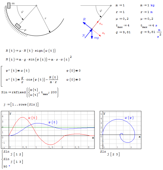

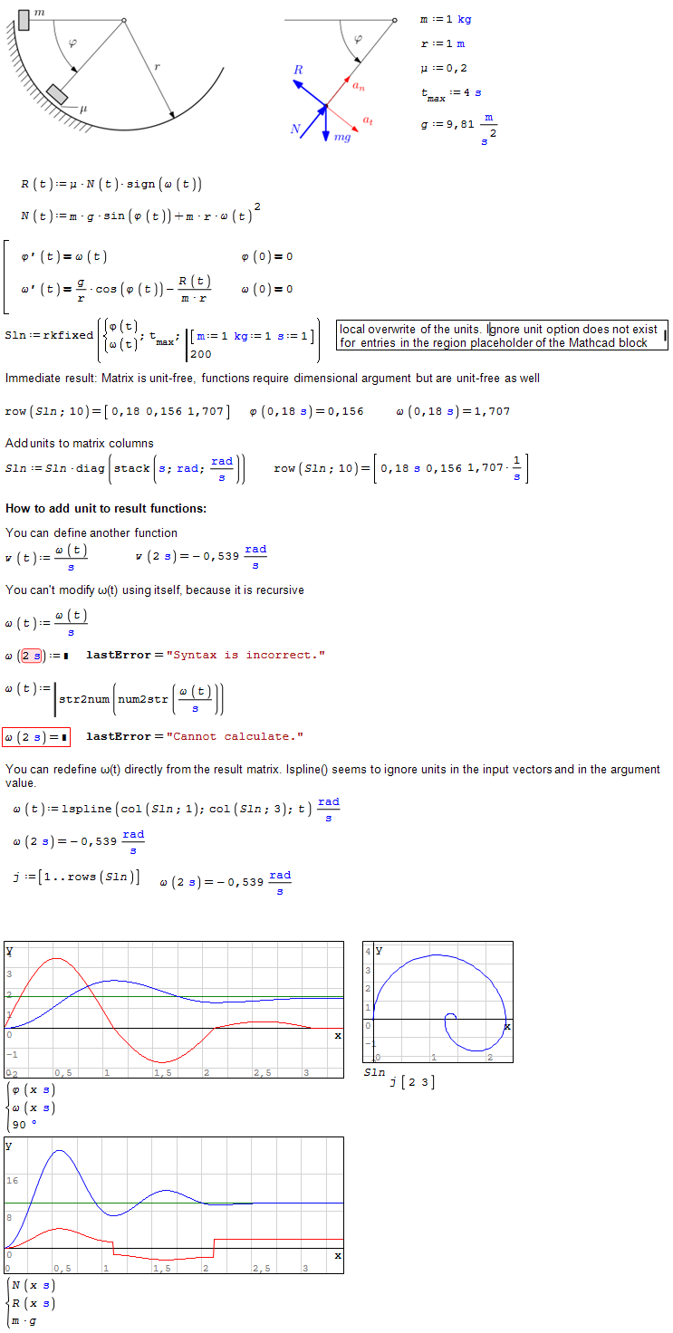

Is there a chance to at least partially use units here? The values with units are disabled in the sheet, this is not visible in the png-file.
7-1.sm (29.01 KiB)已下载 1741 次。
sergio 2023/11/25 19:38:00

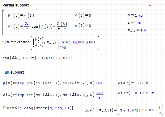

#171 已发布: 2023/11/25 13:26:55
1,139个赞,共1,805个帖子。
This is an option for having partial and full units support.
7-1-units.sm (35.56 KiB)已下载 1717 次。
2位用户喜欢此帖子
sergio 2023/11/25 19:38:00, Martin Kraska 2023/11/25 19:45:00
#172 已发布: 2023/11/25 19:44:24
1,362个赞,共2,276个帖子。
Alvaro, thanks for the hints.
By whatever reason, the unit of the independent variable is respected in rkfixed()=even though it is set to 1 locally. Whatever locally means if that happens in the last input parameter value.
7-1_units.sm (39.68 KiB)已下载 1754 次。

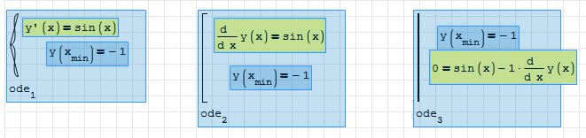

I select the type of bracket for different modes of operation of the block. There are problems with drawing the system sign.
