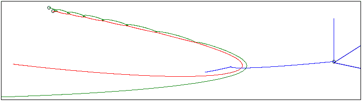

#148 已发布: 2023/4/3 04:19:19
1,558个赞,共1,868个帖子。
Hi. Ok.
A very witty, funny and clean solution.
Click to enlarge
7-13-Three-Planets 5 (Mathcad Block).sm (26.36 KiB)已下载 2197 次。
7-13-Three-Planets 5 (Mathcad Block).pdf (61.72 KiB)已下载 1193 次。
2位用户喜欢此帖子
Alvaro 2023/4/3 06:57:00, Mark R Harris 2023/4/4 16:19:00

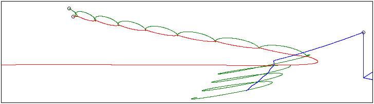

#149 已发布: 2023/4/4 01:59:18
1,558个赞,共1,868个帖子。
Little bit more.
Click to enlarge
7-13-Three-Planets 6 (Mathcad Block).sm (26.11 KiB)已下载 2201 次。
7-13-Three-Planets 6 (Mathcad Block).pdf (67.28 KiB)已下载 1049 次。

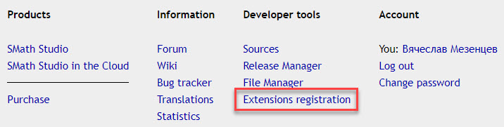

#157 已发布: 2023/4/6 10:29:56
1,558个赞,共1,868个帖子。
Hi. That function looks great. Is there an example of using a document as an add-on?
Try to log in here using the registration data in the program: https://en.smath.com/upload/extensions.aspx
You should see this picture:
Click to enlarge
Next, you need to choose the type of extension
Click to enlarge
Before uploading a file, you need to fill in the document properties. Later, you can delete the file if necessary.
Click to enlarge
If the registration data is not suitable, then you need to request them from Andrey via e-mail.
The registered files will be available through the gallery.
Click to enlarge

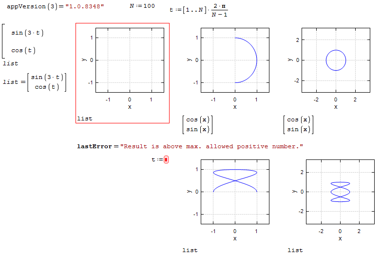

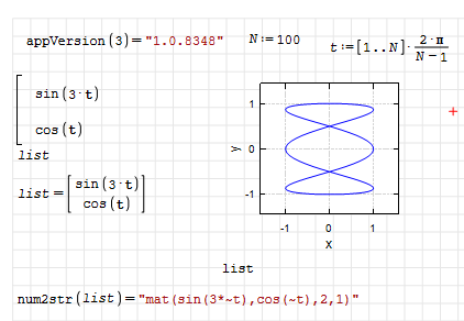

1,362个赞,共2,276个帖子。
Unfortunately, I can't reproduce your parametric plot example.
It seems that the parameter range is taken from the x axis limits. Assigning a range to the parameter makes the plot fail.
How to fix this?
BTW, how about making the glyph of the mathcad block reflect the actual type by using {,[ or | to indicate the vertical extension?
Mathcad block.sm (13.77 KiB)已下载 1749 次。
#160 已发布: 2023/4/17 17:22:41
1,139个赞,共1,805个帖子。
...How to fix this? ...
Use ~t instead t in list, but t in the range.
