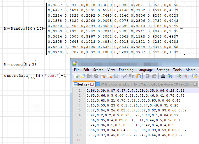

Hello there,
Is there a method for using round() with exportDataCSV?
Perhaps I need to loop through the multi dimensional array and operate on each entry using round(), ahead of using exportDataCSV.
Please point me in the right direction for a robust method.
Tim
#156 已发布: 2017/10/16 12:38:09
1,443个赞,共2,936个帖子。
You can use a loop or vectorize() over the round function
